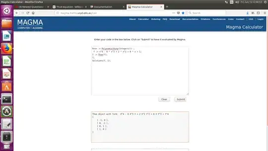

Plugging back in, either to $x^2 - 3 y^2 = -2$ or $2 x^2 - 3 z^2 = -1,$ we get the (integer) equation $$ r^4 - 8 r^3 s + 2 r^2 s^2 + 8 r s^3 + s^4 = 1. $$ This is called a Thue equation. I ran it in gp-Pari, the only solutions are $$ (1,0) \; ; \; (-1,0) \; ; \; (0,1) \; ; \; (0,-1) $$ so that the $x,y,z$ triples can only be made up of $\pm 1 \; .$
I also ran it in the online MAGMA calculator. The syntax in June 2018 has updated compared with published articles. enter image description here
