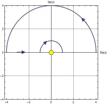

Consider the following integral corresponding to the first integral:
$$\oint_C dz \: \frac{e^{i (1-2 \pi v) z}}{z} $$
where $C$ is the contour defined in the illustration below:
integration contour
This integral is zero because there are no poles contained within the contour. Write the integral over the various pieces of the contour:
$$\int_{C_R} dz \: \frac{e^{i (1- 2 \pi v)z}}{z} + \int_{C_r} dz \: \frac{e^{i (1- 2 \pi v) z}}{z} + \int_{-R}^{-r} dx \: \frac{e^{i (1- 2 \pi v) x}}{x} + \int_{r}^{R} dx \: \frac{e^{i (1- 2 \pi v) x}}{x} $$

By Jordan's lemma, this integral vanishes as $R \rightarrow \infty$ when $1-2 \pi v > 0$. On the other hand,
$$ \int_{C_r} dz \: \frac{e^{i (1-2 \pi v) z}}{z} = i \int_{\pi}^0 d \phi \: e^{i (1-2 \pi v) r e^{i \phi}} $$
This integral takes the value $-i \pi$ as $r \rightarrow 0$. We may then say that
$$\begin{align} & \int_{-\infty}^{\infty} dx \: \frac{e^{i (1-2 \pi v) x}}{x} = i \pi & 1-2 \pi v > 0\\ \end{align}$$
