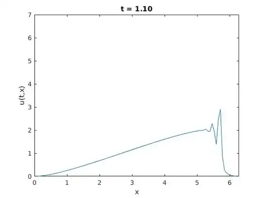

This code produces a plot for each time $t$, where I can't see a multi-valued solution! I just see that things go bad for $t>1$, as expected. In fact, for $t \approx 1.1$, I got the following graphic:
Maybe the problem is that I'm using forward Euler, which is not a good choice?

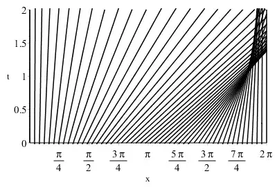

The solution deduced by the method of characteristics becomes multi-valued, as shown in the plot of characteristics below,
char

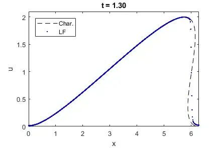

and in the linked figure 3.5 of the OP. The code for it can be found in the comments by @LutzL, and a similar case is examined in this post. In facts, discontinuous weak solutions (shock waves) arise at the breaking time $$t_b = -\frac{1}{\min u'_0(x)} = 1 \, .$$ The shock speed is then given by the Rankine-Hugoniot condition, allowing an analytical expression of the shock profile in many cases.
As outlined in the comments by @LutzL, the method proposed here is called method of lines (MOL). Using explicit Euler time-integration, one gets the scheme $$ u_i^{n+1} = u_i^{n} - \frac{\Delta t}{2\Delta x}\, u_i^n (u_{i+1}^n - u_{i}^n) \, , $$ where $u_i^n \approx u(i\Delta x,n\Delta t)$. This method may be unstable due to incorrect upwinding, which is the cause of the oscillations observed here. A similar upwind-biased version of the method is adequate for smooth solutions but will not, in general, converge to a discontinuous weak solution of Burgers' equation as the grid is refined. A classical choice is the Lax-Friedrichs scheme $$ u_i^{n+1} = \frac{1}{2}(u_{i+1}^{n}+u_{i-1}^{n}) - \frac{\Delta t}{2\Delta x} \left(\tfrac{1}{2}(u_{i+1}^n)^2 - \tfrac{1}{2}(u_{i-1}^n)^2\right) , $$ which is stable under the CFL condition $\max u_j^n \frac{\Delta t}{\Delta x} \leq 1$ and converges to the correct shock profile as the grid is refined.
This is implemented in the Matlab code below

legend('Char.','LF','Location','northwest');
with periodic boundary conditions and the following output:

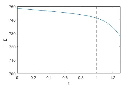

An interesting feature is the decrease of total energy $E(t) = \int u^2(x,t)\, \text d x$ after the shock formation, as observed numerically in the following picture:
