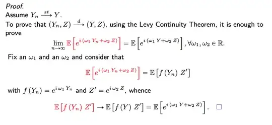

As suggested below I tried with Levy continuity theorem, but I am not sure that it is ok to consider a complex $f$. This is my poof:
  • Probably I have found a solution, quite simple indeed. For every $g(x,z)$ bounded and continuous define $$f(x) = g(x,z)/z$$ which is bounded and continuous in $x$. – AlmostSureUser Apr 12 '18 at 14:00
    From my point of view, it would be easier to use Lévys continuity theorem, i.e. the fact that convergence in distribution is equivalent to convergence of the characteristic functions. – saz Apr 12 '18 at 14:00
  • @saz would this require the adoption of a complex $f$ ? – AlmostSureUser Apr 12 '18 at 15:06
  • Yes, but for this you can write $f = \text{Re} , f+ i , \text{Im f}$ and use the linearity of the expectation – saz Apr 12 '18 at 15:22
