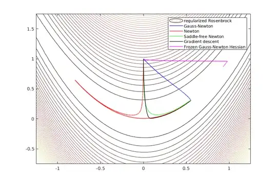

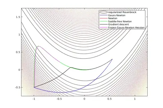

I've been trying to understand this myself. I suspect a complete understanding will come from analysis of the continuous flows associated with the Newton and Gauss-Newton methods. That is, the continuous limit of the (Gauss-)Newton method as the step size goes to zero and the number of steps goes to infinity. Here are some pictures I made comparing the continuous flows associated with the Gauss-Newton method, Newton method, and some others, on a version of the Rosenbrock function that is regularized so that there is a residual at the optimal point. enter image description here
