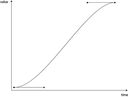

I'm trying to use Bézier curves as an animation tool. Here's an image of what I'm talking about:
Example of a Bézier curve
Basically, the value axis can represent anything that can be animated (position, scaling, color, basically any numerical value). The Bézier curve is used to control the speed at which the value is changing as well as it start and ending value and time. In this graphic, the animated value would slowly accelerate to a constant speed, then decelerate and stop.
The problem is, that Bézier curve is defined with parametric equations.
$f_x(t):=(1-t)^3p_{1x} + 3t(1-t)^2p_{2x} + 3t^2(1-t)p_{3x} + t^3p_{4x}$
$f_y(t):=(1-t)^3p_{1y} + 3t(1-t)^2p_{2y} + 3t^2(1-t)p_{3y} + t^3p_{4y}$
What I need is a representation of that same Bézier curve, but defined as value = g(time), that is, y = g(x).
I've tried solving for t in the x equation and substituting it in the y equation, but that 3rd degree is giving me some difficulty. I also tried integrating the derivative of the Bézier curve (dy/dx) with respect to t, but no luck.
Any ideas?

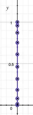

Walking $t$ at even intervals (say in steps of 0.1) takes evenly spaced points along the parametric curve.
So, the answer to your question is really quite simple. The parametric bezier curve provides 2 variables as the output, with only 1 variable as the input. To control an animation in time like these, that's only a 1 dimensional situation. So consider $t$ as time, and drop one variable (say drop $x$). Your animation ease curve is controlled by the $y$ value:
Now as $t=0,0.1..1$, you have an animation parameter that starts slowly, moves at medium speed in the middle, and slows down at the end.

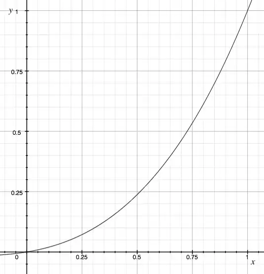

Setting $u_0=0$, $u_1=0.05$, $u_2=0.25$, $u_3=1$ gives an ease-in curve (slow start, fast end)

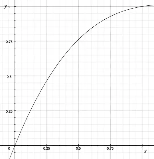

Setting $u_0=0$, $u_1=0.75$, $u_2=0.95$, $u_3=1$ gives an ease-out curve (fast start, slow end)

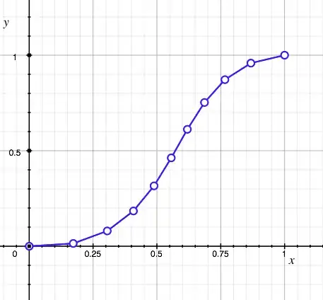

    Walking t at even intervals (say in steps of 0.1) takes evenly spaced points along the parametric curve. -- this is simply not true. Chose a linear bezier path using $u_0 = u_1 = 0, u_2 = u_3 = 1$ and and the resulting $y$ would not be linear at all. – Christian Schnorr Jun 04 '15 at 16:29
    This is equivalent to fixing ${p_2}_x=\frac{1}{3}$ and ${p_3}_x=\frac{2}{3}$ giving $f_x(t)=t$. This restricts the expressiveness a bit. – fryguybob Jul 24 '15 at 14:17
    yea wtf, you're assuming each X point is fixed at 0.33 and 0.66, then just adjusting Y values, rather than being able to drag the control points around – neaumusic Mar 01 '17 at 15:10

I tried the two solutions I've linked to the original question (Solution 1 and Solution 2). Here are my results.
Solution 1
The idea is to recreate the curve with a third degree polynomial, by matching the value at P1 and P4 and their respective slope. This polynomial can be solve using a system of linear equations. The only problem is that it's possible to create an infinite slope at P1 or P4 with the Bezier curve, which is impossible to recreate with the polynomial. I've also tried using a 5th degree polynomial (matching value, first derivative and second derivative) without success, because it has the same problem.
Solution 2
This solution is pretty simple, but a bit hacky. The idea is to use the De Casteljau algorithm to search for a t (parameter of the Bézier curve) that matches a given x variable (x-axis). The algorithm is simple :
  1. Split the curve in half
  2. Is the x of the split point is approximatively equal to the searched x? If yes, return t
  3. Else, if the searched x is greater that the x of the split point, repeat the algorithm with the segment on the right, else on the left.
Once you have the t, you can obtain the y value using the Bézier function $f_y(t)$ in my original post.
So, yeah, working, but a bit hacky.
