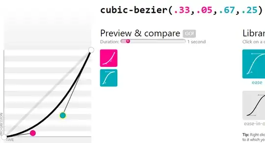

Example in the answer above, an ease-in curve has $u_0=0$, $u_1=0.05$, $u_2=0.25$, $u_3=1$ but if we use the point it should be $P_0=(0,0); P_1=(0.42,0); P_2=(1,1); P_3=(1,1); $ (you can see it here).

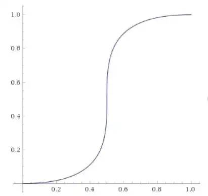

For example, suppose you try to find a function corresponding to the 2D curve with control points $\mathbf{P}_0 = (0,0)$, $\mathbf{P}_1 = (1,0)$, $\mathbf{P}_2 = (0,1)$, $\mathbf{P}_3 = (1,1)$. This curve looks like this:
You can't possibly represent this curve as the graph of a polynomial function (of any degree) because it has vertical slope at $x=\tfrac12$, which would never happen with a polynomial. If you want to use this curve for 1D animation, then you need to be able to calculate the $y$ value for a given $x$. In general, you will need to solve cubic equations to do this, which requires either nasty unstable formulas or numerical methods like Newton-Raphson. This particular example is very special because the relevant cubic is easy to solve, giving us: $$ y = \frac{1}{48}(36 - 24x) + \frac34 (2x-1)^{1/3} $$ But this is highly unusual; the solution of a cubic equation is typically a huge mess.

  • Thank you for your answer. It helped me so much. I see in your answer that we need to fix the x-cordinate of 4 points to map it to the function but in the http://cubic-bezier.com the $P_0=(0,0), P_3=(1,1)$ and the input is $P_1(x_1, y_1), P_2(x_2, y_2)$. It is same as css cubic-bezier function. Is there any way that we can achieve it? – Duannx Dec 19 '17 at 02:27
  • I'm not sure what you're asking. But I'm guessing that it might be the issue I discuss in the new paragraph at the end of my answer. – bubba Dec 19 '17 at 08:07
  • It is what i am asking about. Css has a cubic-bezier() function what have $P_0=(0,0), P_1=(x_1, y_1), P_2=(x_2, y_2), P_3=(1,1)$ and some how it can use $P_1$ and $P_2$ as the input to control the animation. – Duannx Dec 19 '17 at 08:33
  • After all, i can use the function with the control value $(0, y_1, y_2, 1)$ to control animation but it is better if i can make my function like the css way. – Duannx Dec 19 '17 at 08:39
  • Yes, but there are two different things: the function with control values $0,y_1,y_2,1$, and the 2D Bezier curve with control points $(0,0), (x_1,y_1), (x_2,y_2), (1,1)$. The two graphs won't be the same unless $x_1 = \tfrac13$ and $x_2 = \tfrac23$. – bubba Dec 19 '17 at 08:49
  • Thank you so much. At least i have a function to control the animation. I will keep finding the way to implement exactly css cubic-bezier function. – Duannx Dec 19 '17 at 09:02
  • I would guess that the css implementation uses numerical methods internally to calculate the $y$ corresponding to a given $x$. You could do the same, but it's a bunch of work. Much easier to use a Bezier function instead. – bubba Dec 19 '17 at 09:09
  • I hope css does not use that way because css animation is very lightweight. – Duannx Dec 19 '17 at 09:32
