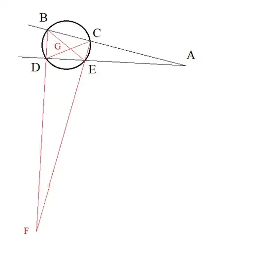

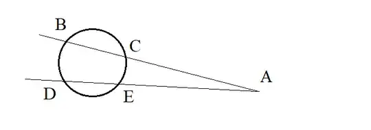

Draw two lines through $A$, crossing the circle. For the next step to be possible, the lines need be in different distances from (unknown...) center of the circle.
Name the intersections of one line and a circle $B$ and $C$, for the other line: $D$ and $E$:
Find a point $F$ at the intersection of lines $BD$ and $CE$, and $G$ at the intersection of $BE$ and $CD$:

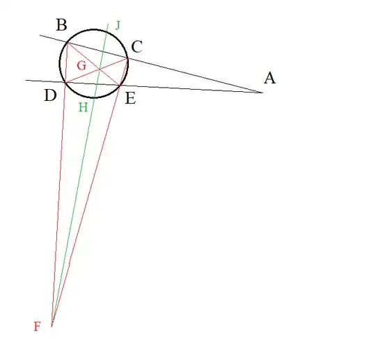

Now find $H$ and $J$ as intersections of the line $FG$ with the circle:
Voilà: lines $AH$ and $AJ$ are tangent to the circle.
