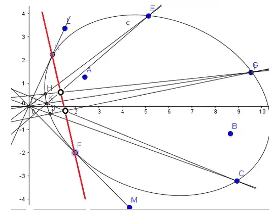

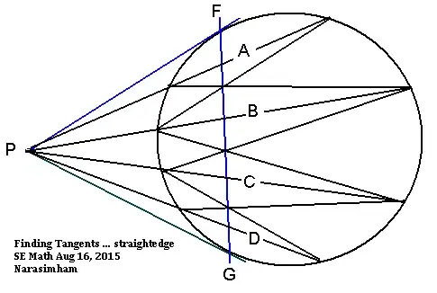

It is a consequence of Pascal's theorem in Projective geometry valid for any conic, the circle is a special case. When separation tends to zero, the secant points $(OA_1, OA_2)$ where $(A_1, A_2) $ are extremities of chord on circle which multiply to tangent point $F$ as
$ OA_1 OA_2= OB_1 OB_2=...= OD_1 OD_2= PF^2$ as constant product, a property of the circle.
The locus,chord $ FG $, is a straight line. As a property of circle it is the harmonic mean of segments $ (OA_1, OA_2) $ as,for all chords e.g.,
$$ 2/PF = 1/OA_1 + 1/OA_2. $$
Conclusion:
Pascal line is the chord of harmonic means of a pencil/circle intersection
Pascal Line Circle
Pascal Line valid on ellipse also, but I do not know if that is the harmonic locus. (posted Sept 2, 2016).
Pascal Line Ellipse
Narasimham
  • 42,260
  • I'm not sure I understand your answer completely. I was previously unaware of Pascal's theorem and it seems useful. You say that the Pascal line corresponding to the choice of the three lines is the line $FG$. But the Pascal line could change if we change the three lines, so I don't see how the limit argument works exactly. It seems that the Pascal line is indeed independent of the choice of the three lines, but this requires an argument. And I don't see how the harmonic mean is relevant here. Can you elaborate? – Joonas Ilmavirta Aug 15 '15 at 19:37
  • If $ A_1 $ is brought near to $ A_2$ by shifting up our straight edge it tends to position $F$.as a double point of tangency. Similarly with $C'$ s and $G$. Since harmonic mean leads to an invariant property chord line for all rays like $ PA_1A_2, ...,...$ the initial choice in relative positioning of $ A, B , C $ should not matter. – Narasimham Aug 15 '15 at 20:13
    Added a hand made Paint sketch, poor accuracy, for sake of reference. The pole/polar discussion is also relevant here., – Narasimham Aug 15 '15 at 20:41

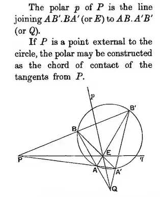

The short answer is that the points $E,F$ are on the polar $p$ of $P$ with respect to the circle, and the tangents from $P$ go through the points where $p$ intersects the circle. Moreover, this construction works for all conics, not just circles. And you can get away with a construction that uses fewer lines.
There are lots of 19th century projective geometry texts on archive.org that explain this, but I'll point you to Hatton's Projective Geometry, pg 132.
This illustration from that page shows the construction.
Hatton Polar
This construction gets away without computing $F$ because $Q$ is also on the polar. The proof for this construction is give in the two preceding pages of the reference, and actually starts from the construction you give (chords $AA',BB',CC'$).
brainjam
  • 9,172

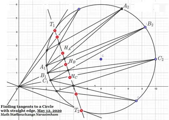

EDIT1:
Harmonic mean $HM$ segments are of length $$ (OA_1, OA_2) = OH_A,\, (OB_1, OB_2) = OH_B,\,(OC_1, OC_2)= OH_C,..$$ measured from the pole $O$ always lie on the polar line represented by red circle locus. It contains points $ (H_A, H_B, H_C..) $ and end tangent points $ T_1 T_2 $ where the power of the circle is $ OT_1^2=OT_2^2$.
Pole & Polar
It is interesting that the neighboring segments can be used as well for this purpose as the points of intersection (black circles) continue to be on the polar, a fact interestingly relevant to draw chord line as tangent points $ T_1 T_2 $ connecting line.
Narasimham
  • 42,260
  • It is continuation of an earlier answer (where I have mentioned about harmonic mean) can now be found another way. – Narasimham May 12 '20 at 18:45
