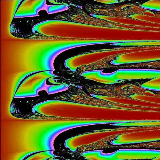

The fact is that $sin(D)$ is sampling the more broader non-discrete continuous expression $sin{(\alpha)}, \alpha \in [0,2\pi]$. As $D$ is a natural number, $D \pmod {2 \pi}$ is equidistributed along $[0,2 \pi]$. I wanted to see how looks the relationship of $D$ and $t$ via a escape time algorithm. So the escape time algorithm for a given initial condition $(x_0,y_0)$ is how many $n$ steps are required to reach a stable orbit (if it is ever reached). As a result, the darker the color is, the quicker $(x_0,y_0)$ reaches a stable orbit for the specific combination of $D$ and $t$. The cases in black color are not able to reach a stable orbit, they stay in a chaotic absorbing area. And it looks like this:
The image shows the cases in which $(x_0=0,y_0=0)$ arrives to a stable orbit or a chaotic absorbing area, the $x$-axis is $t \in [0,10]$ and $y$-axis are the samplings of ($D \pmod{2\pi}$) along the interval $[0,2\pi]$ ($0$ is at the top and $2\pi$ is at the bottom, is the whole domain, so indeed the bottom continues naturally again in the top, is a cylindrical map).

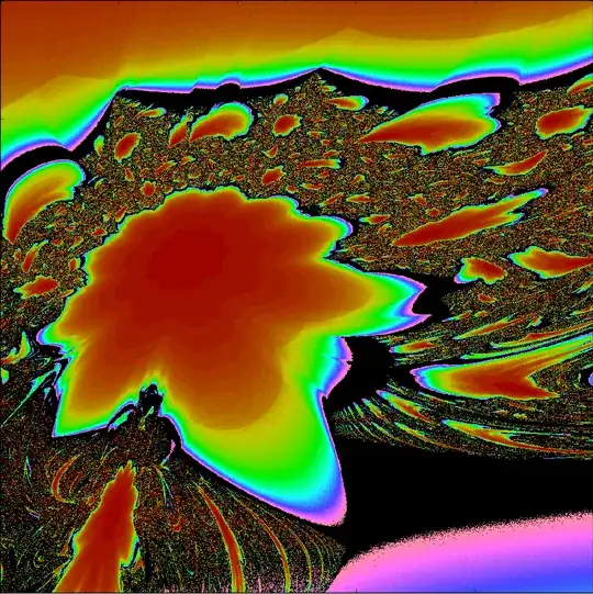

The second image is a zoom-in of the initial image for $x$-axis $\in [5,5.5]$ and $y$-axis $\in [950,100]$ (a little leaf-like pattern at the bottom of the first image).
