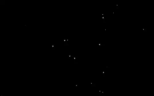

Defined as above, each one of the dynamical systems of the family is bi-dimensional (only $x$ and $y$ are variables). For instance, here is a zoom of the visualization of just one of the attractors, for $t=2, f=1$ and $D=136$ and iterating each one of them in $n \in [0,8 \cdot 10^3]$:
It is just a zoom of a little region inside $[-5,5]×[-5,5]$, showing some of the points of the complete $S_{D=136,t=2,f=1}$ attractor, which is a $73$-periodic attractor. The spark effect is just to make the points easier to see.

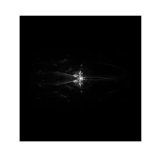

But the properties of these systems are more interesting when the whole family is visualized as a unique system including all the $D$ (Depth) integer bifurcations, than visualizing each one of the $D$-bifurcations individually, as it happened in the previous image. It looks like this, for instance for $t=2, f=1$ and showing all the bifurcations associated with $D \in [0,8 \cdot 10^3] \in \Bbb N$ and iterating each one of them in $n \in [0,8 \cdot 10^3]$ in the same image (click to zoom):
So it is a picture of the whole family of attractors associated to the $D$-bifurcations, all at once in the region $[-5,5]×[-5,5]$. It includes indeed the previous example of a single attractor of the family, $S_{D=136,t=2,f=1}$. It is possible to see that, while a single specific $D$ attractor has not a very clearly defined structure, the structure and symmetries of all the $D$ bifurcations together can be distinguished clearly.
