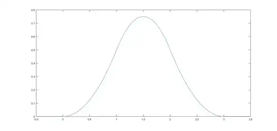

Use the definition. Therefore$$f_W(w)=f_S(w)*f_Z(w)=\int_{-\infty}^{\infty}f_S(w-u)f_Z(u)du=\int_{0}^{1}f_S(w-u)du=\int_{w-1}^{w}f_S(u)du$$for $w<0$ and $w>3$ the integral is zero. For $0<w<1$ we have $$f_W(w)=\frac{w^2}{2}$$for $1<w<2$ $$f_W(w)=-w^2+3w-\dfrac{3}{2}$$and for $2<w<3$ $$f_W(w)=\dfrac{(w-3)^2}{2}$$A sketch of $f_W(w)$ is as following:
