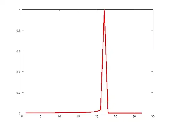

$${\bf X_{n+1}} ={\bf X_n}- f({\bf X_n})f'({\bf X_n})^{-1}$$ As long as you set initial $\bf X_0$ to nothing too crazy, it will work. In fact, this is the simplest example of an discrete fractional integration solution, if you look at larger matrices $d$ filled with 1 on and below the diagonal and 0 otherwise (ok, transpose of the same matrix but same idea).
The fractional integral operators in fractional calculus found if guessing at the $\bf X_0 = \bf I$ matrix (described as linear convolutional filters, corresponding to a row in the solution matrix):
The two we recognize is the one in the middle (constant, corresponding to normal integral) and the one at the end (linear, corresponding to double integration).
