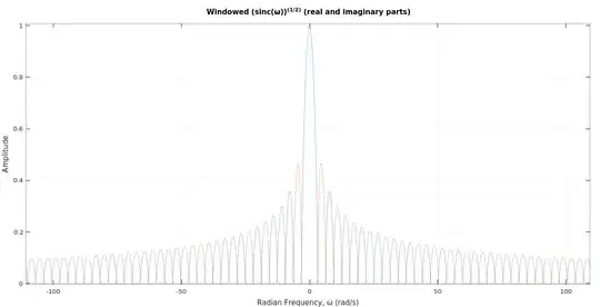

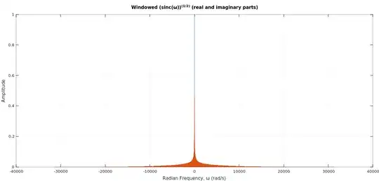

This figure shows a plot of the real and imaginary parts of the truncated, windowed $(\mathrm{sinc}(\omega))^{\frac{1}{2}}$ function:
This is that same figure zoomed in on the center:
which shows an alternation of the real and imaginary parts due to the positive and negative excursions of $\mathrm{sinc}(\omega)$ (before the square root was taken).

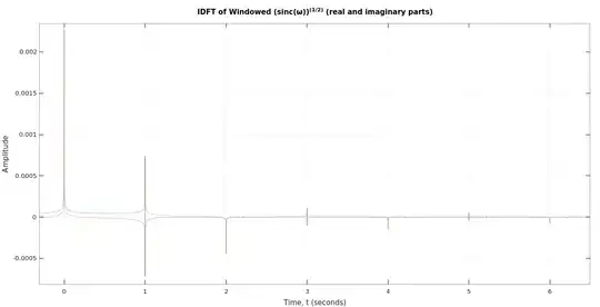

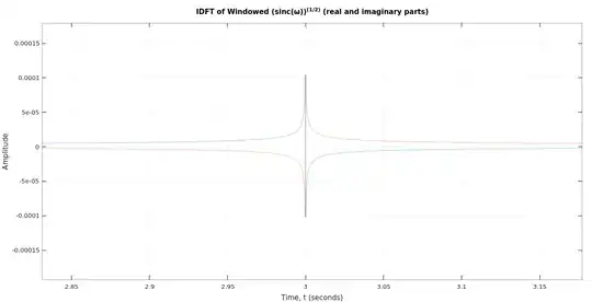

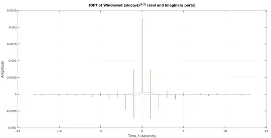

The next few figures plots of the real and imaginary parts of the IDFT of the truncated, windowed $(\mathrm{sinc}(\omega))^{\frac{1}{2}}$ function, with various regions zoomed in:
enter image description here enter image description here enter image description here
From these plots, it is fairly reasonable to conjecture that the Inverse Fourier Transform of $(\mathrm{sinc}(\omega))^{\frac{1}{2}}$ is an infinite sum of shifted, weighted $\delta(t)$ and $\delta'(t)$ impulses. Something like
$$\begin{align*}f(t) &= (a_0 + ib_0)\delta(t) \\ &+ \sum_{n=-\infty}^{-1} (-a_{2n+1} +i b_{2n+1})\delta'(t - [2n+1]) + (-a_{2n}-ib_{2n})\delta(t -2n) \\ &+ \sum_{n=1}^{\infty} (a_{2n-1} -i b_{2n-1})\delta'(t - [2n-1]) + (-a_{2n}-ib_{2n})\delta(t -2n) \\ \\ &= (a_0 + ib_0)\delta(t) \\ &+ \sum_{n=1}^{\infty} -\left(a_{2n} + ib_{2n}\right)\left[\delta(t+2n)+\delta(t-2n)\right] \\ &+ \sum_{n=1}^{\infty} -\left(a_{2n-1} - ib_{2n-1}\right)\left[\delta'\left(t+\left[2n-1\right]\right)-\delta'\left(t-\left[2n-1\right]\right)\right] \\ \end{align*}$$
with $|a_m| = |a_{-m}|$ and $|b_m| = |b_{-m}|$ and likely $|a_m| = |b_m|$.
I didn't bother to try and do a curve fit to figure out the envelope and the nominal values of the $a_m$'s and the $b_m$'s, especially since my windowing scales the values. I suspect they follow an envelope that is a power of a $\mathrm{sinc}()$ function, but that is pure speculation.
