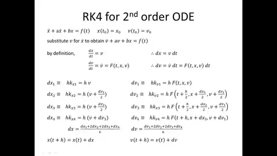

Second Order ODE
However I am unable to find any direct formulae to solve higher order ODEs(3rd and 4th order). Is there a straight forward way to implement RK4 for higher order ODEs?
