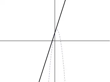

Informally, the "quadratic" polynomial with a=0 has a second zero at the compactification point at infinity. Graphically (working in the reals):
animated graph
So, as a goes through zero, the "quadratic" goes through the linear special case, where the second zero goes through infinity, crossing between the positive and negative ends of the real axis.
I believe that this parallels the more technical explanation given by Qiaochu Yuan.

  • Where'd you get the image from? Or did you make it yourself? – Casebash Aug 16 '10 at 09:09
    @Casebash: I made it in Mathematica. It's $y=3x+6$ and $y=ax^2+3x+6$ for values of a from -1 to 1 in steps of 1/30, viewed on [-40,40]x[-30x30] (at least, to the best of my recollection, as I didn't save the source file). – Isaac Aug 16 '10 at 09:14
