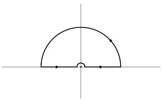

I’m posting this answer because I’ve found a way to evaluate it using contour integration. First, set$$f(z)=\frac {\log^2z}{a^2+z^2}$$And choose a semi circle contour with a small semi circular detour around the origin on the upper half of the complex plane. Let the larger circle have a radius of $R$ and samaller circle have a radius of $r$.
Therefore$$\oint\limits_{C}dz\, f(z)=\int\limits_r^Rdx\, f(x)+\int\limits_{\gamma_R}dz\, f(z)+\int\limits_{-R}^{-r}dx\,\frac {(\log|x|+\pi i)^2}{a^2+x^2}+\int\limits_{\gamma_r}dz\, f(z)$$The residue at $z=ai$ is$$\operatorname{Res}(f,ai)=\frac {\pi\log a}{2a}+\frac {4\log^2a-\pi^2}{8ai}$$So the residue theorem gives$$\oint\limits_Cdz\, f(z)=\frac {4\pi\log^2a-\pi^3}{4a}+\frac {\pi^2 i\log a}a$$Both arc integrals vanish as $R\to\infty$ and $r\to0$ so we are left with$$2\int\limits_0^{\infty}dx\, f(x)-\frac {\pi^3}{2a}=\frac {4\pi\log^2a-\pi^3}{4a}$$Hence$$\int\limits_0^{\infty}dx\,\frac {\log^2x}{a^2+x^2}=\color{blue}{\frac {\pi}{2a}\left(\log^2a+\frac {\pi^2}4\right)}$$
