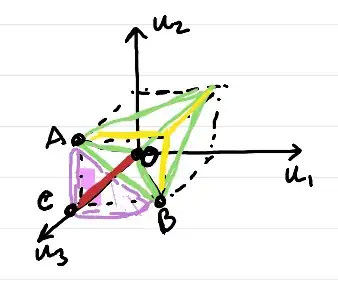

If you describe an elephant to a kid but never show them the picture of one, they won't truly appreciate it.
What the (very good) answer by Hagen Von Eitzen is missing is a picture.
See the green triangles emnating from the origin, O? Those form the base of the three tetrahedra he's referring to.
Consider one of those three Terahedra, OABC. This represents the region, $u_3 > u_1+u_2$.
We can choose its base, ABC. This is a right triangle and has an area of $\frac{1}{2}$. The height of this tetrahedron is the red line, OC. And that is $1$. The volume of a Tetrahedron in 3-d space is one third of the area of its base multiplied by the height. So, the volume of OABC is $\frac{1}{3} \times \frac{1}{2} \times 1 = \frac{1}{6}$. Its also easy to see that the three Terahedra don't intersect.
Rohit Pandey

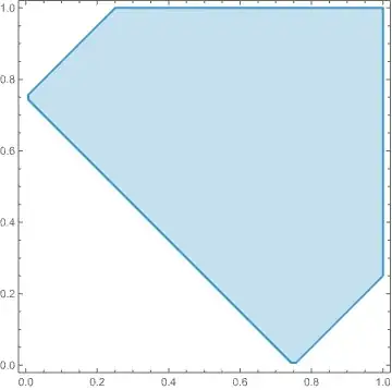

The answer by user1551 is very nice but it feels somewhat out of the blue. Here is a more intuitive variation where we directly condition on $Z$.
Let $z\in (0,1)$ be fixed. We look for $$P(X < Y + z, Y< X + z, z < X+Y).$$ Since $(X,Y)$ has uniform distribution on the unit square, this probability is the area of the region $R = \{(x,y)\in [0,1]^2: x < y + z, y< x + z, z < x+y\}$. The region $R$ is easily sketched, see below when $z=3/4$.
https://i.imgur.com/HxISU6e.png
The area of $R$ is found by subtracting the area of the complement: $$1-\frac {z^2}2 - 2\cdot \frac {(1-z)^2}2 = 2z - \frac{3z^2}2$$ and the final probability is $$E\left[2Z - \frac{3Z^2}2\right] = \frac 12.$$
