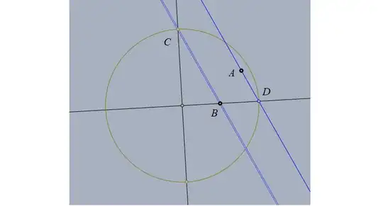

First, consider the analytic solution of the problem.
Let the coordinates of the points in the figure below be: $B=(b,0)$, $A=(u,v)$, $D=(R,0)$, and $C=(0,R)$.
The slope of the double line is $-\frac Rb$. As a result, the equation of the thin line is
$$-\frac Rb=\frac{y-v}{x-u}.$$
If $y=0$ then $x=R$ in the case of the thin line. Taking this into account, we get an equation for the right $R$s:
$$-\frac Rb=\frac{-v}{R-u}$$
or $$R^2-uR-bv=0.$$
The solutions are $$R_{1,2}=\frac12(u\pm\sqrt{u^2+4bv}).$$ This formula shows that the segment of length $R$ can be constructed if segments of lengths $u,v$ and $b$ are given.
See this article to learn how to multiply segments. See this answer to learn how to take square roots. Addition, subtraction, and halving must be obvious.

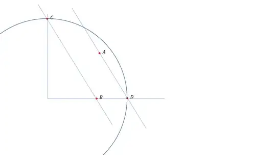

A drawing of what I think is being asked, just to help others get started: enter image description here

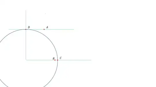

No...wait: here's a solution (to what I think cannot be what the problem intended):
Draw a (green) line through $A$ parallel to the green leg containing $B$; let its intersection with the other leg be $D$. Draw a circle of center $O$ and radius $OD$, meeting $B$'s leg at location $C$. Now $BC$ is the green leg, and $AD$ is parallel to it.
John Hughes
  • 100,827
  • 86
  • 159
  • I was going to post a picture was just uploading it, your first drawing is fine but a can be inside as well. your solution i dont follow from your bottom picture clearly line AD is not parallel to line BC? for one they interect so they cannot possibly be parallel. – Faust Nov 21 '17 at 16:53
  • You're completely right -- I had in my head "AC parallel to BD", which isn't what's needed at all. I'll delete that second bit. THanks! – John Hughes Nov 21 '17 at 16:56
  • And now I've re-fixed that so that it's "correct", if you believe my interpretation of the problem (which is that $C$ is not constrained, by what's asked, to lie on the other leg from $B$). – John Hughes Nov 21 '17 at 17:58
  • Lmao that's a hilarious solution! – Faust Nov 21 '17 at 18:04
  • That's what I thought....but I have a hard time believing it's what Hartshorne intended. My recollection is that his problems were never easy. – John Hughes Nov 21 '17 at 18:08

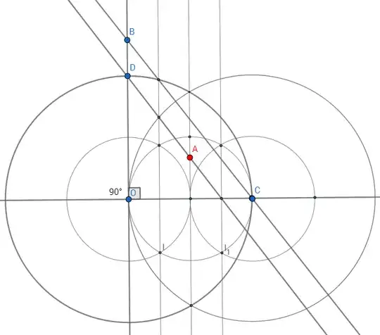

I think the answer is the following:
  • Looks like you drop a perp from $A$ to bottom leg, draw circle at $O$ through intersection point; reflect that across the perpendicular you dropped, and call the new circle-center $C$. (I.e., OC is twice $OK$, where $K$ is the foot of the perpendicular). The you draw a circle with center $O$ and containing $C$. But what happens if you raise $A$ about 4 inches in your picture? Nothing in the construction of $C$ changes, but $AD$ is no longer parallel to $BC$. I must be missing something. – John Hughes Nov 21 '17 at 17:00
  • Sorry this can't be correct, the choice of B is arbitrary and nothing in the construction is dependent on the choice of B, he must be picking C s.t the line BC has A contained in it when thats possible? – Faust Nov 21 '17 at 17:24
