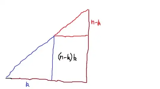

I am sure your instructor will want an algebraic proof, so don't turn this in as your proof, but here's a 'Proof by Picture' for the inductive step:
Explanation:
The claim is that $n$ stones you will eventually end up with $\frac{n(n-1)}{2}$ stones, which is the sum of all numbers $1$ through $n-1$ ... which is the number of little squares in the figure above.
Now, if you divide your pile into two piles of $k$ and $n-k$, you gain $k(n-k)$ points (the number of blue squares), plus whatever points you can get by dividing the pile with $k$ stones and the pile with $n-k$ stones. By inductive hypothesis, however, the $k$ stones will give you the sum of $1$ through $k-1$ (the white squares above the blue squares), and the $n-k$ stones will give you the sum of $1$ through $n-k-1$ (the white squares to the right of the blue squares), and so we see that indeed this all adds up to $\frac{n(n-1)}{2}$
