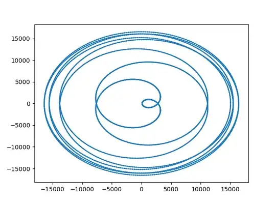

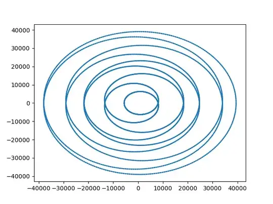

I have written some code (attached below) that generates a random real polynomial $P$ degree and coefficient within some range. I then plotted and looked at $im(P(S^1)) $ with $S$ being the unit circle in the complex plane.
To my surprise I got pictures with some interesting properties. (Interesting at least for me, (pictures are viewable below))
I noticed:
  1. The figure is connected (not too surprising)
  2. The figure is self-intersecting itself and an intersection seems to be always crossed exactly twice. (Might be wrong, considering rounding errors etc.)
  3. The intersection points $z_i$ seem to have Im$(z_i) = 0$
Point 1. follows directly from S being compact and $P$ continuous. However I find it harder to justify 2 and 3, especially I can make such a claim, maybe I were just lucky with my numbers. Therefore I would appreciate it, if someone could clarify points 2 and 3 to me, if those statements are correct and especially why. As always thanks in advance.
Figure1 Figure2

Ad 2: A polynomial with threefold intersection would be $$f(x)=(x^3-1)x.$$
Ad 3: It is clear that the image is symmetric with respect to the $x$-axis, which automatically causes intersection points there as soon as the curve crosses the $x$-axis non-perpendicularly. Nevertheless, $f(x)=x^2$ can be said to pass twice hrough each of its point (even though this might be considered cheating). Maybe try $$ f(x)=x^3+(x^{9}-1)x$$
