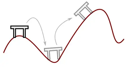

At first I went one diemnsion lower. I tried to move a two dimensional table along a function-graph by keeping the legs on the ground. I asked: is it always possible to move the table from the left to the right without loosing touch with the ground?
Lets formalize this. Again the ground is a continuous function $f:\Bbb R\to\Bbb R$. A point $p\in\Bbb R$ is lifted to $\bar p=(p,f(p))\in\Bbb R^2$. Instead of a unit-square, here we have to keep the touching point of the legs with the ground in the form of a unit interval, i.e. at distance one.
Question: Given a continuous function $f:\Bbb R\to\Bbb R$ and $x_0,x_1,y_0\in\Bbb R$ with $\|\bar x_0-\bar y_0\|=1$. Are there continuous functions $x,y:[0,1]\to\Bbb R$ so that
  1. it holds $x(0)=x_0$, $y(0)=y_0$ and $x(1)=x_1$,
  2. it holds $\|\bar x(t)-\bar y(t)\|=1$ for all $t\in[0,1]$.
Looking at the above sketch, this might seem trivial. However, when we choose functions like $f(x)=100 \sin(x^2)$ and want to move the table from $x_0=0$ to $x_1=100$, it is not clear that this can be done. Try it! I will now demonstrate you my approach to solve this question and the problems I encountered on the way.

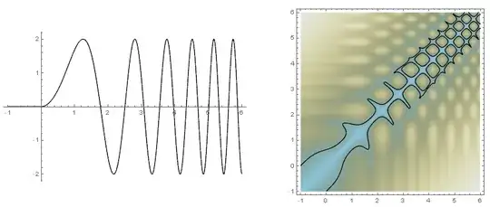

Define the function $d(x,y):=\|\bar x- \bar y\|$. Note that $d$ is a function $\Bbb R^2\to\Bbb R$, hence describes a height map over a two-dimensional area. The $x(t)$ and $y(t)$ in the above formulation are the positions of the table legs at each point in time. Condition 2. is then equivalent to $d(x(t),y(t))=1$. Hence we are interested in paths of constant "height 1" in the height map given by $d$.
For example, the following figure shows on the left a plot of $f(x)=2\sin(x^2)$, and on the right the associated hightmap. The black points are all the points with $d(x,y)=1$.
It looks pretty complicated. But the good thing is that there is indeed a path (the black curve) connecting the bottom of the plot with the top. The $x$- and $y$-coordinates of this path are the desired $x(t)$ and $y(t)$ functions of how to move the tables legs. The hard part is to show that such a path exists always. I tried to show this using some generalizations of the intermediate value theorem but there are sitations where this approach fails. And I was not able to proof that such situations cannot occure for this problem.
The second observations are the closed loops in the right figure. They indicate positions in which the table can be placed, but from which he cannot escape. This was strong evidence for me that the problem is highly non-trivial. How do I know that such locked situations do not occure in the case of a square table? Why should I be able to rotate the table while keeping the legs on the ground? What if I am in such a separate connected component as in the above simplified problem?
