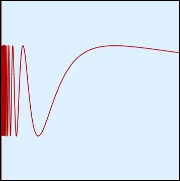

Color $(x,y)\in[0,1]^2$ red if $x=0$ or $y=1/2\cdot\sin(1/x)$. Color everything else blue. There are no paths of either color connecting its respective edges.
Note that the red path does not "reach" the line $x=0$. See also this post and the counterexample in the answers: "Intermediate Value Theorem" for curves
