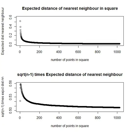

Empirically it is between $\dfrac{0.5}{\sqrt{n-1}}$ and $\dfrac{0.56}{\sqrt{n-1}}$, tending towards the lower bound as $n$ increases. This is not very different to putting $n-1$ random points in a circle or square with area $1$ and finding the expected minimum distance to the centre.
At the bottom end with $n=2$, the question becomes the expected Euclidean distance between two random points in a square, which an earlier answer gives as $\frac{1}{15}(2+\sqrt{2}+5\log(1+\sqrt{2})) \approx 0.5214$
Simulation results look like this, both directly and multiplying by $\sqrt{n-1}$
with values of
n    expected dist nn     sqrt(n-1) times expected dist nn
2           0.521                   0.521
3           0.389                   0.550
4           0.322                   0.557
5           0.279                   0.558
6           0.250                   0.558
7           0.227                   0.557
8           0.210                   0.555
9           0.196                   0.553
10          0.184                   0.552
20          0.124                   0.540
50          0.075                   0.527
100         0.052                   0.519
200         0.036                   0.514
500         0.023                   0.509
1000        0.016                   0.507
(See comments) The simulation code was

Henry
  • 169,616
  • So I guess these results are for a unit square ($m=1$). Did you use floating point numbers as the coordinates of the points? I suppose you used a pseudorandom number generator to get these coordinates. How many times did you calculate these values for each $n$? – Adam Sep 01 '17 at 12:59
  • @Adam. As you guessed, this is based on a unit square but you can just scale distances by the side of the square. I used R, which has double precision (so nearly 16 decimal digits), and I simulated $1$ million points with their nearest neighbours for each $n$. So I expect the rounded numbers in my table are accurate to $\pm0.001$ or better. I will add the simulation code – Henry Sep 01 '17 at 13:33
