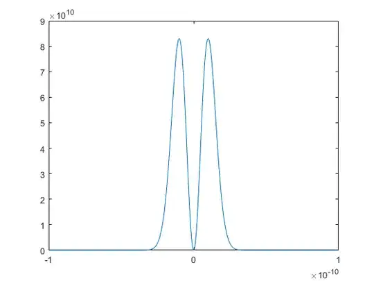

Consider Maxwell-Boltzmann distribution:
$$f(v,T)=\left(\frac{m}{2\pi kT}\right)^{3/2} 4\pi \,v^2 \exp\left(-\frac{m}{2kT}v^2\right)$$ where $m$ is molecule's mass, $k$ is Boltzmann constant, $v$ is molecule's speed and $T$ is temperature. i want to calculate following limit: $$\lim_{T\rightarrow0} f(v,T)=?$$
I plotted the function $f$ in Matlab and the result for $T=0.0000000000000000000001$ is as follows. It seems that the limit goes to the Delta function at two points near zero. Can someone please help me to show that mathematically?

First, I'd like to point out that your graph is incorrect. The Maxwell-Boltzmann distribution is a speed distribution; it is only defined for nonnegative $v$.
Anyways, let's write this in a simpler form using the thermal speed $v_T = \sqrt{T/m}$. $$ f(v,v_T) = \sqrt{\frac{2}{\pi}}\frac{1}{v_T} \left(\frac{v}{v_T}\right)^2\exp\left[-\frac{1}{2}\left(\frac{v}{v_T}\right)^2\right] $$ So how does this function behave? We have \begin{eqnarray} \forall v , \lim_{v_T\rightarrow 0}f(v,v_T) &=& 0\\ \forall v_T , \int_0^\infty f(v,v_T)dv &=& 1\\ \max_{v\in[0,\infty)}f(v,v_T) = f(\sqrt{2}v_T, v_T) &=& \frac{2\sqrt{2}}{e\sqrt{\pi}}\frac{1}{v_T} \end{eqnarray} There's clear parallels to the delta function here: vanishes almost everywhere, has finite integral, and appears to be the limit of an increasingly peaky function. However, the limit is actually zero everywhere, whereas most limit expressions of delta functions at least have one point where the limit diverges. So in that way its limit isn't a delta function. Pointwise, it converges to the zero function.
On the other hand, the delta function isn't a function at all. Its real defining factor is the integral sifting property: $ \int_a^b g(x)\delta(x)dx = f(0)$ if $a < 0 < b$. So if you could show $$ \lim_{v_T\rightarrow 0}\int_0^\infty g(v)f(v,v_T)dv = g(0) $$ for all $g$, that would in a sense show its limit is (sort of) a delta function. This can probably be done using function value estimates, but I'll leave that as an exercise for the reader.
