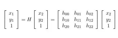

An example from opencv: we have two images of the same place, taken from different angle. We will compute homography H. If we now select one pixel with coordinates (x1, y1) from the first image and another pixel (x2, y2) that represents the same point on another image, we can transform the latter pixel to have the same viewing perspective as the first one by applying H:
OpenCV example of applying homography
As we see, it is identical to applying transformation matrix, hence homography is just a special case of transformation. Most examples that I have seen, consider homography only for 2D (i.e., for images). Still, homography can be extended to larger dimension (source). Thanks to homography, 3D to 2D planar projection (i.e., mapping coordinates in 3D space to points on 2D plane) reduces to 2D to 2D, i.e., to a less complex problem (source).

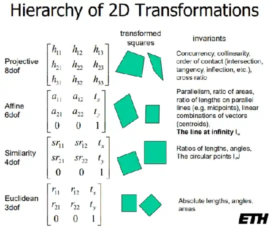

I found out that yes, a homography matrix's elements are unconstrained - and it is synonymous to a projectivity. To answer the question of what a homography actually is, it is useful to compare the concept of a homography also to Affinity, Similarity, Euclidean Transforms, etc. Those are all constrained more strongly, so the word homography is useful to explicitly state that the matrix may not adhere to those stronger constraints.
To this purpose, I find this comparison useful:
Hierarchy of 2d Transformations
Source: https://www.cvg.ethz.ch/teaching/3dvision/2020/slides/class02eth20.pdf
So a "transformation matrix" is a general term and a "homography" is technically the same, but I believe it is used mainly to point out that there are no further constraints. That is, I would not say that an Affine Transformation is a Homography when I know that it is always affine. But I would call an Affine Transformation a Transformation - like wikipedia does here, for example.
