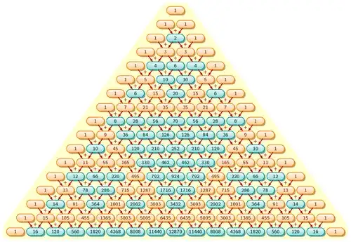

I recently learned that when the Pascal's triangle is reduced to parity(ie even terms are represented as 0, odd terms are represented by 1), the result is a figure resembling Sierpinski's triangle in pattern. This I found to be a very fascinating result. Then I began to notice some sequences, such as particular sequences of zeroes and ones appearing in various rows.
An observation I made is that as Pascal's triangle is symmetric by way of $\binom{n}{m}= \binom{n}{n-m}$, the reverse of any sequence of 0s and 1s that appears in this version of Pascal's triangle will also appear. Looking at various sequences, the shortest sequences to not seem to appear were $1101$ and its reverse, $1011$. I attempted to then prove two things. First, I wanted to prove that these sequences would never appear in the 'parity Pascal triangle'. I can see intuitively why they would never appear- if we divide the Sierpinski triangle into stages of itself, we see that the $101$ sequence only appears in the middle row of the second stage of the fractal, and as the $nth$ stage of the fractal only appears as part of the $n+1$th stage of the fractal, this sequence will always be followed by the center of $0$s of another stage of the fractal. Similarly, any sequence $100...11$ can appear, but $1011,100011, 1000000011$, and so on with the number of 0s being of form $2^n-1$ cannot appear. As I said, intuitively this is because $2^n-1$ 0s bookended by two 1s appears at places where either one of the two 1s is on the edge of the fractal and the other at the edge of the central triangle of 0s in some stage of the fractal. For examples of this happening, see the bottom row of the diagram, the third row of the diagram, the fifth row of the diagram, the ninth row of the diagram. Can anyone formalize this argument into a full, general proof of my statement?
