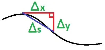

How can we get the thickness (or length) of the boundary? We need to approximate the boundary with tiny line segments. Each line segment can be viewed as the hypotenuse of a tiny right triangle whose legs are parallel to the $x$- and $y$-axes. The leg parallel to the $x$-axis has length $\Delta x$ and the leg parallel to the $y$-axis has length $\Delta y$. If we let $\Delta s$ denote the length of our tiny line segment then we get $\Delta s = \sqrt{(\Delta x)^2 + (\Delta y)^2}.$
Here's a picture illustrating this. Imagine this is some function that we very closely zoomed in on:
So, each of our little tiny disks has surface area approximately given by $2\pi y(x) \sqrt{(\Delta x)^2 + (\Delta y)^2}$. Note that our disks actually have slanted boundaries. (The line segments whose lengths are $\Delta s$ are the boundaries of our disks.) This is why I said "approximate disks" earlier: Our tiny disks for surface area are not perfect disks (like we had for volume) because they're actually disks with slanted boundaries. And this whole slanted boundary thing is necessary here because we must accommodate for the slant of the function, because that slant affects the boundaries of our disks (but not their interiors, which is why we didn't care about slant for the volume).
Anyway, we can rewrite the approximate surface area of each slanted-boundary disk as: $$ 2\pi y(x) \sqrt{(\Delta x)^2 + (\Delta y)^2} = 2\pi y(x) \sqrt{(\Delta x)^2 \left[\frac{(\Delta x)^2}{(\Delta x)^2} + \frac{(\Delta y)^2}{(\Delta x)^2}\right]} = 2\pi y(x) \sqrt{1 + \left(\frac{\Delta y}{\Delta x}\right)^2} \, \Delta x$$
