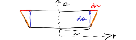

Here's a super-rough sketch by hand:
This is a sketch of one of your "slices" enclosed between two very close planes in heights $z$ and $z + \mathrm{d}z$, where by $\mathrm{d}z$ I mean an infinitesimally small increment of $z$. The distance of the curve from the axis of rotation is $r$ in the lower plane and slightly different $r + \mathrm{d} r$ in the upper one.
So what happens when you calculate the volume of the slice? You just calculate the volume of a small cylinder with radius $r$ and height $\mathrm{d} z$, getting $\pi r^2\,\mathrm{d} z$. Notice that in the sketch, this is the rectangle with two black horizontal and two blue vertical lines. So by counting like that, we're essentially "throwing away" the little colorful triangles.
Why do we get the correct answer? It's because the triangles are way too small and they give zero volume when rotated. You can intuitively see that just by looking at the areas in the sketch: you count the volume that corresponds to the black/blue rectangle with area $r\,\mathrm{d} z$, and throw away the triangle with area $\tfrac12 \mathrm{d} r\,\mathrm{d}z$. So the volume of the slice is infinitesimally small, and the volume of the triangle is infinitesimally small with respect to that infinitesimally small slice. It's "infinitesimally small squared"; no wonder it doesn't contribute.
However: when you calculate the surface area with your method, you're still counting the surface area of the little cylinders (i. e. the blue bits in the sketch). Sadly, that won't do, because the "real surface" is the orange one. And you're using $\mathrm{d} z$ where you should really use the length of the sloped orange line, which is $\sqrt{\mathrm{d} z^2 + \mathrm{d} r^2}$ (just apply the Pythagorean theorem to the colorful triangle). $\mathrm{d} r$ and $\mathrm{d} z$ are pretty similar in magnitude, so you can't just throw one of them out and expect to get away with it — it's like saying that $\sqrt2$ is pretty much equal to $1$ because $\sqrt2 = \sqrt{1 + 1}$ and we can neglect one of the $1$'s!
So, taking your half-sphere $r = \sqrt{R^2 - z^2}$, we first need to calculate
$$ \mathrm{d} r = \frac{\mathrm d (R^2 - z^2)}{2\sqrt{R^2-z^2}} = \frac{- z\,\mathrm d z}{\sqrt{R^2 - z^2}}. $$
And the surface area of the slice is essentially the surface of a cylinder with radius $r$ and height $\sqrt{\mathrm d z^2 + \mathrm d r^2}$, so it needs to be
$$ \mathrm{d} S = 2\pi r \sqrt{\mathrm d z^2 + \mathrm d r^2} = 2\pi \sqrt{R^2 - z^2} \times \sqrt{\mathrm d z^2 + \frac{z^2}{R^2 - z^2} \mathrm d z^2} = 2\pi R |\mathrm d z|. $$
Integrate this from $z = 0$ to $z = R$ to get the $2\pi R^2$ that we know is correct.
