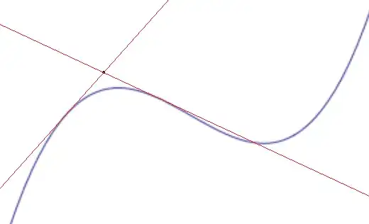

Because sometimes a picture really is worth a thousand words:enter image description here
Paul Sinclair
  • 45,932
    @scott - I made this a community wiki post simply because I thought a picture would help illustrate the several good answers that were already present. You should pick your favorite of the other answers and mark it as correct. – Paul Sinclair Apr 29 '17 at 17:03
    Just because it's a saying doesn't mean it's true. I didn't understand how this picture spoke to the question until I read some of the other answers. So it wasn't worth any words to me without an explanatory caption of some sort. – Todd Wilcox Apr 30 '17 at 03:33
    @ToddWilcox - I've already said I posted it to illustrate what the other answers were talking about.(as a community wiki post, I get no credit for the upvotes). I didn't explain it exactly because I was illustrating their posts, not making an independent answer. – Paul Sinclair Apr 30 '17 at 03:47

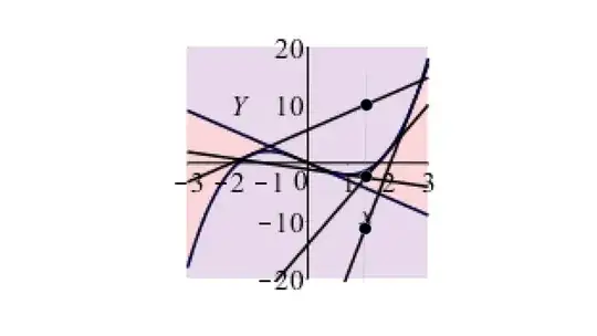

SOLUTION. Consider a cubic C with its inflexion point at the origin, $y= x^3+cx$, with tangent T through the origin $y=cx$. Then if $c\ge 0$ there always exists only one line tangent to $C$ through a given point P not on C. If $c<0$ there are two tangents through any point P located between C and T or on T. Through any other point there is only one tangent. Note that there is only one straight line from every point of which two tangents are always possible, and that is T itself. This is evident from inspection of this graph; an analytical proof is left to the reader.
In the question, the inflexion point is at $x=3$ and the tangent through the inflexion point is $$y=y(3)+y'(3)(x-3)=q+27-(p+27)x$$ and if this is to coincide with the line $y=3-x$ on which P always lies, then $p=-26$ and $q=-24$.enter image description here
