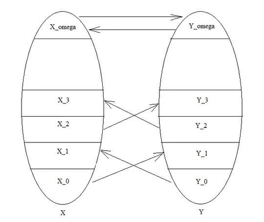

$\newcommand{\ran}{\operatorname{ran}}$Here’s one way to think about it. Suppose that $y\in\ran f$; then we can pull $y$ back to $f^{-1}(y)\in X$. If $f^{-1}(y)\in\ran g$, we can pull it back to $g^{-1}(f^{-1}(y))\in Y$. If we continue this pulling back, one of two things must happen: either we reach a dead end at a point of $X$ or $Y$ that can’t be pulled back (because it’s in $Y\setminus\ran f$ or $X\setminus\ran g$), or we don’t.
Let $X_0=X\setminus\ran g$, the set of points of $X$ that cannot be pulled back at all, and let $Y_0=Y\setminus\ran f$. More generally, for each $n\in\omega$ let $X_n$ be the set of points of $X$ that can be pulled back exactly $n$ times, and let $Y_n$ be the set of points of $Y$ that can be pulled back exactly $n$ times. Finally, let $X_\omega$ and $Y_\omega$ by the subsets of $X$ and $Y$, respectively whose points can be pulled back infinitely many times.
At this point a sketch helps; it should show the partitions $\{X_n:n\le\omega\}$ of $X$ and $\{Y_n:n\le\omega\}$ of $Y$, and it should include arrows indicating what parts of $X$ get mapped to what parts of $Y$ and vice versa. To avoid having arrows crossing, I’ve taken $X$ and $Y$ apart in the following diagram.
$$\begin{array}{} X_0&\overset{f}\longrightarrow&Y_1&\overset{g}\longrightarrow&X_2&\overset{f}\longrightarrow& Y_3&\overset{g}\longrightarrow&X_4&\dots&X_\omega\\ Y_0&\overset{g}\longrightarrow&X_1&\overset{f}\longrightarrow&Y_2&\overset{g}\longrightarrow&X_3&\overset{f}\longrightarrow&Y_4&\dots&Y_\omega \end{array}$$
Each of the arrows is a bijection, so I can break up the diagram into $\omega$ self-contained parts. The first two parts are:
$$\begin{array}{} X_0&\overset{f}\longrightarrow&Y_1\\ Y_0&\overset{g}\longrightarrow&X_1 \end{array}\qquad \begin{array}{} X_2&\overset{f}\longrightarrow&Y_3\\ Y_2&\overset{g}\longrightarrow&X_3 \end{array}$$
Ignoring $X_\omega$ and $Y_\omega$ for the moment, I can rearrange the rest of the diagram to give me a bijection from $X\setminus X_\omega$ to $Y\setminus Y_\omega$:
$$\begin{array}{ccc} X_0&\overset{f}\longrightarrow&Y_1\\ X_1&\overset{g^{-1}}\longrightarrow&Y_0\\ X_2&\overset{f}\longrightarrow&Y_3\\ X_3&\overset{g^{-1}}\longrightarrow&Y_2\\ \vdots&\vdots&\vdots\\ X_{2k}&\overset{f}\longrightarrow&Y_{2k+1}\\ X_{2k+1}&\overset{g^{-1}}\longrightarrow&Y_{2k}\\ \vdots&\vdots&\vdots \end{array}$$
Finally, I claim that $f[X_\omega]=Y_\omega$: everything in $X_\omega$ can be pulled back infinitely often, so everything in $f[X_\omega]$ can be pulled back infinitely often, and therefore $f[X_\omega]\subseteq Y_\omega$. On the other hand, if $y\in Y_\omega$, then $y$ can be pulled back infinitely often, so it must be possible to pull $f^{-1}(y)$ back infinitely often, and therefore $f^{-1}(y)\in X_\omega$. Thus, $Y_\omega\subseteq f[X_\omega]$ as well. The diagram above can now be completed to show a bijection from $X$ onto $Y$:
$$\begin{array}{ccc} X_0&\overset{f}\longrightarrow&Y_1\\ X_1&\overset{g^{-1}}\longrightarrow&Y_0\\ X_2&\overset{f}\longrightarrow&Y_3\\ X_3&\overset{g^{-1}}\longrightarrow&Y_2\\ \vdots&\vdots&\vdots\\ X_{2k}&\overset{f}\longrightarrow&Y_{2k+1}\\ X_{2k+1}&\overset{g^{-1}}\longrightarrow&Y_{2k}\\ \vdots&\vdots&\vdots\\ X_\omega&\overset{f}\longrightarrow&Y_\omega \end{array}$$
The bijection is defined piecewise, but that’s no problem.
There are a few details to be filled in to make this a fully rigorous proof, but I think that it does give a reasonable idea of one possible intuition.
Added: Here’s a very rough sketch. Arrows from left to right are (parts of) $f$, and arrows from right to left are (parts of) $g$.
Brian M. Scott
  • 631,399
  • I'm having a hard time following this. Where you note that "at this point, a sketch helps" - what does this sketch look like? How have you taken the sets X and Y apart into their partitions? – Chris Oct 30 '12 at 23:38
  • @user1296727: I thought that the diagrams made that pretty clear; I don’t have very good facilities for doing so, but I’ll try to add a picture in a bit. – Brian M. Scott Oct 31 '12 at 00:00
  • Thank you for the diagram; it helps. When you say something is in $X_n$, do you mean that, by $n$ iterations of alternately pulling it back into Y, and then X, and then Y... you can get to something which can't be pulled back? (Otherwise, I don't see why the functions are bijections.) – Chris Oct 31 '12 at 00:26
  • @user1296727: Yes, that’s exactly right. Each pull-back is from one set to the other, so they must alternate. – Brian M. Scott Oct 31 '12 at 00:28

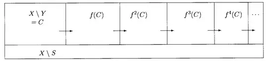

My favorite proof is due to R. H. Cox, and I learned it from the wonderful Handbook of Analysis and its Foundations by Schechter, from which I've taken the illustration below. The basic idea is that an injection from $Y$ to $X$ identifies $Y$ with a subset of $X$. So we can reduce the problem to showing that if we have $Y\subseteq X$ and $f:X\to Y$ is an injection, then $|X|=|Y|$ and this is less confusing. let $C=X\backslash Y$. The sequence of sets $\big(f^n(C))$ is disjoint since $f(X)\subseteq Y$ and $f$ is injective. Let $S=\bigcup_{n=0}^\infty f^n(C)$. Define $g:X\to Y$ by
$$g(x) = \begin{cases} f(x)&\mbox{if } x\in S \\ x & \mbox{if }x\notin S. \end{cases}$$
It is easily verified that $g$ is a bijection.
Remark: According to Kunen's book on the foundations of mathematics, Dedekind already proved this version of the Cantor-Bernstein theorem in 1887.
  • Yes, this theorem has quite the history. It's buried in a link [maybe in the comments] in one of my answers about the topic. – Asaf Karagila Oct 30 '12 at 23:40
  • @Asaf: I actually found the original reference online. I guess you refer to this comment by Theo. – Michael Greinecker Oct 30 '12 at 23:52
  • This proof is more succinct, but I don't know about clear. Why the heck would I expect your function $g$ to be a bijection? Why would I expect that this continued iteration of $f$ from the image of $X/Y$, over and over again, coupled with $X/Y$, would give me something in bijection with $X \cap Y$?! – Chris Oct 30 '12 at 23:54
  • @Michael: Yes, that's the one. – Asaf Karagila Oct 30 '12 at 23:57
  • @user1296727 Look at the picture. – Michael Greinecker Oct 31 '12 at 00:03
    I did...? (Please do be explicit, I'm juggling two proofs at once.) – Chris Oct 31 '12 at 00:04
  • @user1296727 I think it should be clear why $g$ is a bijection. The identity maps $X\backslash S$ to itself and $S$ is constructed so that $f$ is injective on it and $f(S)\subseteq X$. Clearly, every point in $X\backslash f(S)$ is in $X\backslash S$ since $f(S)\subseteq S$. – Michael Greinecker Oct 31 '12 at 00:13
  • Let me rephrase. I get how the proof wraps up - $f(x)$ takes things in $S$ to $Y$, and something not in $S$ was in $X \cap Y$ to begin with, thus the identity mapping suffices, so $g$ is surjective (and obviously injective). What I don't get is, why would I ever expect (starting from scratch) that this whole argument - your post - would get me a bijection? – Chris Oct 31 '12 at 00:19
  • In this setting, you have o make somehow use of the $f$. You do not have to worry about points in $Y$ not being the image under $f$, since you can always apply the identity function there. So apply $f$ only to $X\backslash Y$. But you cannot map the points in $f(X\backslash Y)$ tot hemselves since they are alread in the range of $f$. So apply $f$ again.. The point is not that it is obvious that the result is correct, for this the proof using ordinals works better, but if there is a constructive proof at all, it should look something like this. – Michael Greinecker Oct 31 '12 at 00:27
  • @madmatician Basically, in order to make the proof comprehensible in terms of the picture. The proof doesn'tstrictly require it, the intuition IMHO does. – Michael Greinecker Aug 06 '16 at 23:29

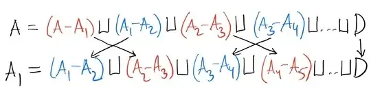

Hence we have the partition
$${ A = (A - A _1) \sqcup (A _1 - A _2) \sqcup \ldots \sqcup (A _k - A _{k+1}) \sqcup \ldots \sqcup D }$$
where
$${ D := \bigcap _{k=1} ^{\infty} A _k .}$$
How does ${ g \circ f }$ act on these pieces?
Note that ${ g \circ f }$ maps
$${ {\begin{aligned} &\, A - A _1 \rightsquigarrow A _2 - A _3 , \\ &\, A _2 - A _3 \rightsquigarrow A _4 - A _5, \\ &\, \quad \vdots \end{aligned}} }$$
and
$${ {\begin{aligned} &\, A _1 - A _2 \rightsquigarrow A _3 - A _4, \\ &\, A _3 - A _4 \rightsquigarrow A _5 - A _6, \\ &\, \quad \vdots \end{aligned}} }$$
Hence in the partition
$${ A = {\color{red}{(A-A _1)}} \sqcup {\color{blue}{(A _1 - A _2)}} \sqcup {\color{red}{(A _2 - A _3)}} \sqcup {\color{blue}{(A _3 - A _4)}} \sqcup \ldots \sqcup D }$$
where the red parts and the blue parts have same size.
Note that we have bijections
IMG 0838 Copy
Hence ${ A }$ is equivalent to ${ A _1 , }$ as needed. ${ \blacksquare }$
