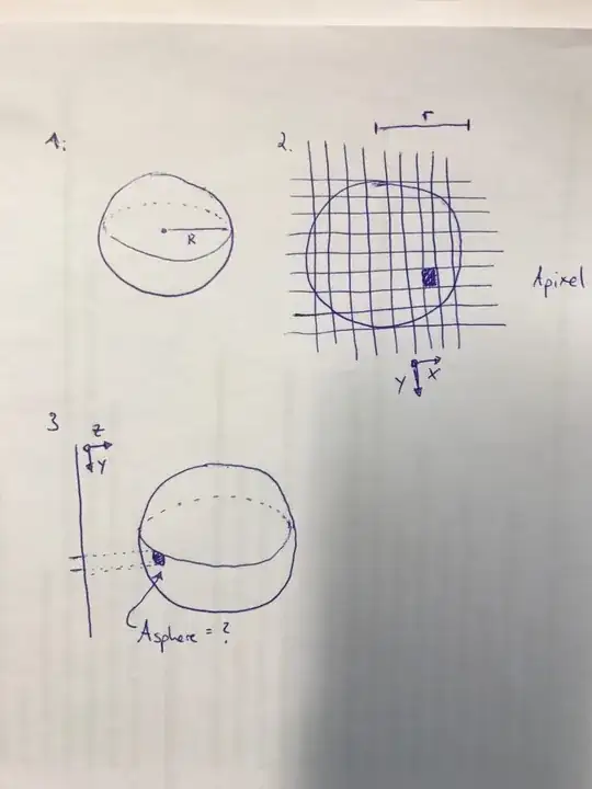

Given an photographical image of a sphere, i.e. an circle with radius $r$ quantized into uniform, square pixels, how can one calculate the equivalent area of the sphere covered by each pixel?
I'm assuming that the projection is parallel.
Example: Let a sphere of radius $R = 1$ be projected to a circle with a radius of $r = 100\,\mathrm{px}$, where the center of the sphere is the center of the middle pixel $(50, 50)$ in the image.
Basically I'm interested in the reverse projection from the pixel space to the sphere.
I guess I have to cast rays from the corners of the pixel onto the sphere and from those four points get the area of the sphere in the section that is encased in the four points.
Sketch of the setup.

  • I am especially interested in the difference of the areas covered by the pixels. I need to solve an engineering problem, were I have to calculate a metric based on the spherical area from image data. This is why I need to normalize the areas with respect to the pixel positions.
    Say, I have a Sphere that has a black painting, which has some white spots. I want to calculate the ratio of white to black area on the sphere from the image.

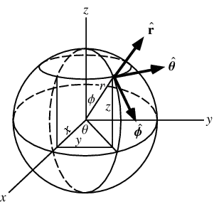

An area element in spherical coordinates is given by $$\mathrm d A=r^2\sin\phi \mathrm d\phi \mathrm d\theta,$$ following the convention shown here:
Place your sphere at the origin and say your projection is orthogonal to the $x,y$-plane, i.e. parallel to the $z$-axis. You now have a pixel. Let its bottom-left corner (as seen in the $x,y$-plane) have coordinate $(nd,md)$ with $d$ being the pixel width and $|n|,|m|<\frac{r}{d}$. You now project this pixel onto the sphere and want to know what the corresponding area on the sphere is. To do this, simply integrate the above mentioned area element over the limits in spherical coordinates corresponding to the change in $x$ and $y$, being $x_1=nd\rightarrow x_2=(n+1)d$ and $y_1=md\rightarrow y_2=(m+1)d$ respectively. However, we want to find these limits in terms of $\theta$ and $\phi$, i.e. $\theta_1,\theta_2$ and $\phi_1,\phi_2$, so that we can calculate the projected area of pixel $n,m$ by $$A_{nm}=\int_{\phi_1}^{\phi_2}\int_{\theta_1}^{\theta_2}\mathrm d A.$$ We have that
\begin{align} \theta&=\arctan\left(\frac{y}{x}\right) \\ \phi&=\arccos\left(\frac{z}{r}\right). \end{align}
