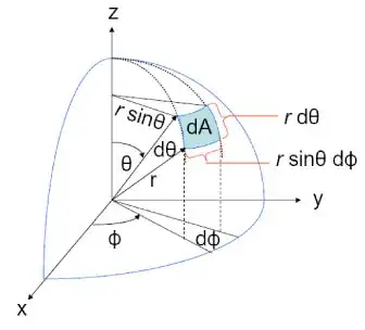

I've come across the picture you're looking for in physics textbooks before (say, in classical mechanics). A bit of googling and I found this one for you!area element on sphere

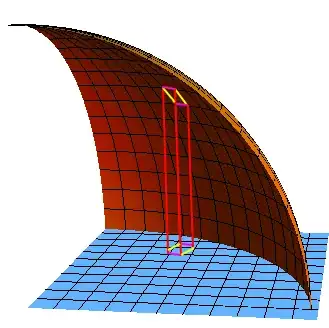

Here's a picture in the case of the sphere:
Projecting surface element onto the Cartesian plane
This means that our area element is given by $$ dA = | X_u \times X_v | du dv = \sqrt{|X_u|^2 |X_v|^2 - (X_u \cdot X_v)^2} du dv = \sqrt{EG - F^2} du dv. $$

    Yea I saw that too, I'm just wondering if there's some other way similar to using Jacobian (if someday I'm asked to find it in a self-invented set of coordinates where I can't picture it) – Rcwt Apr 14 '12 at 15:10
    @R.C. I've edited my response for you. Perhaps this is what you were looking for... ? – tentaclenorm Apr 26 '12 at 04:58

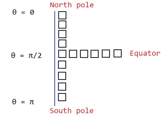

In baby physics books one encounters this expression. In each infinitesimal rectangle the longitude component is its vertical side. The latitude component is its horizontal side.
$$\int_{0}^{ \pi }\int_{0}^{2 \pi } r^2 \sin {\theta} \, d\phi \,d\theta = \int_{0}^{ \pi }\int_{0}^{2 \pi } \overbrace{ \underbrace {r \, d\theta}_{\text{longitude component}} *\underbrace {r \, \color{blue}{\sin{\theta}} \,d \phi}_{\text{latitude component}}}^{\text{area of an infinitesimal rectangle}} $$
We see that the latitude component has the $\color{blue}{\sin{\theta}}$ adjustment to it. This is key. Why is that?

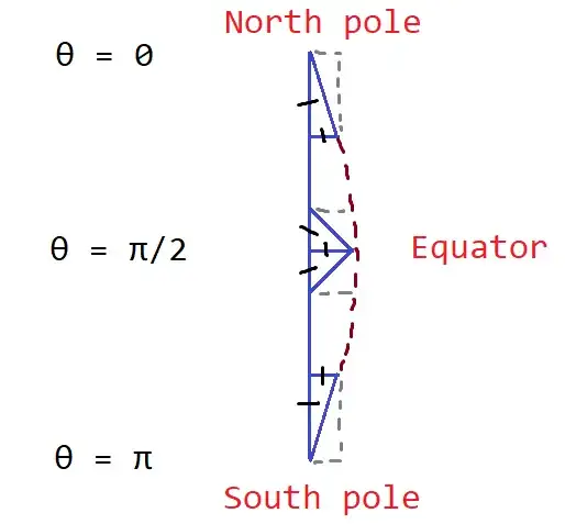

It is because rectangles that we integrate look like ordinary rectangles only at equator! Where $\color{blue}{\sin{\frac{\pi}{2}} = 1}$, i.e. where we do not need to adjust the latitude component. Near the North and South poles the rectangles are warped. Here is the picture.
The blue vertical line is longitude 0. The brown line on the right is the next longitude to the east. Blue triangles, one at each pole and two at the equator, have markings on them. These markings represent equal angles for $\theta \, \text{and} \, \phi$.
We need to shrink the width (latitude component) of integration rectangles that lay away from the equator. Because only at equator they are not distorted. Why we choose the sine function? Intuitively, because its value goes from zero to 1, and then back to zero. That is, where $\theta$ and radius $r$ map out the zero longitude (part of a circle of a plane).
What happens when we drop this sine adjustment for the latitude?
Case B: drop the sine adjustment for the latitude
In this case all integration rectangles will be regular undistorted rectangles. Their total length along a longitude will be $r \, \pi$ and total length along the equator latitude will be $r \, 2\pi$. Total area will be $$r \, \pi \times r \, 2\pi = 2 \pi^2 \, r^2$$
Like this $$\int_{0}^{ \pi }\int_{0}^{2 \pi } r \, d\theta * r \, d \phi = 2 \pi^2 r^2$$
