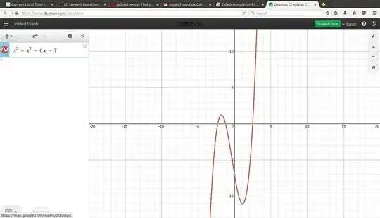

  • Most of the above was partly me showing off. Just from plotting the polynomial you can tell that it has three real zeros. Cardano's formula is the brute force method for finding the roots. You need a bit more to show that adjoining one gives you the others as well. Whenever we get a cubic cyclic extension of $\Bbb{Q}$ some trick like the one above will work (but Kronecker-Weber is too deep a theorem to get covered in a first course in Galois theory). – Jyrki Lahtonen Mar 28 '17 at 10:47

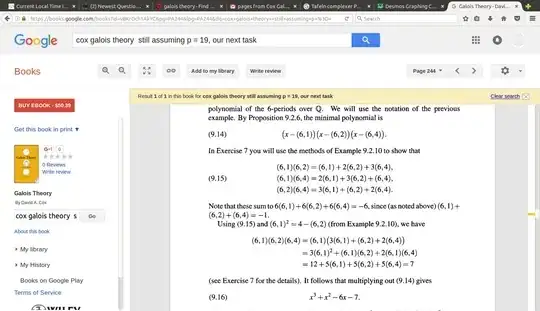

I guess Jyrki wanted me to post something here. Gauss initiated a study of cyclotomic fields in the Disquisitiones. I found a modern treatment in chapter 9 of Galois Theory by David A. Cox.

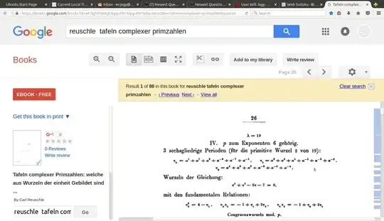

If we begin with your polynomial $g(x) = x^3 + 2 x^2 -5x +1 ,$ then we take $$ f(x) = - g(-x-1) = x^3 + x^2 - 6x - 7. $$ This example is given on page 26 of Reuschle and page 244 of Cox. Given a 19th root of unity $\alpha,$ the three roots, which are real, are expressed as sums of powers of $\alpha.$ Furthermore, these are always paired as a root plus its reciprocal, resulting in cosines.
$$ \eta_0 = 2 \cos \left( \frac{2 \pi}{19} \right) + 2 \cos \left( \frac{14 \pi}{19} \right) + 2 \cos \left( \frac{16 \pi}{19} \right) \approx 2.5070 $$ $$ \eta_1 = 2 \cos \left( \frac{4 \pi}{19} \right) + 2 \cos \left( \frac{6 \pi}{19} \right) + 2 \cos \left( \frac{10 \pi}{19} \right) \approx -2.2851 $$ $$ \eta_2 = 2 \cos \left( \frac{8 \pi}{19} \right) + 2 \cos \left( \frac{12 \pi}{19} \right) + 2 \cos \left( \frac{18 \pi}{19} \right) \approx -1.221 $$
Note that Reuschle provides some multiplications, $$\eta_0^2 = 4 - \eta_1, \; \; \eta_0 \eta_1 = -1 + \eta_1 + 2 \eta_2, \; \; \eta_0 \eta_2 = -1 + \eta_0 + 2 \eta_1 $$ Getting there: $$ \eta_1 \eta_2 = -4 - \eta_0 -3 \eta_1 - 2 \eta_2, $$ $$\eta_1^2 = 4 - \eta_2,$$ $$ \eta_2^2 = \frac{1}{2} \left( 11 + \eta_0 + 3 \eta_1 + 3 \eta_2 \right). $$ Symmetric things $$ \eta_0 + \eta_1 + \eta_2 = -1, $$ $$ \eta_1 \eta_2 + \eta_2 \eta_0 + \eta_0 \eta_1 = -6, $$ $$ \eta_0 \eta_1 \eta_2 = 7, $$ $$ \eta_0^2 + \eta_1^2 + \eta_2^2 = 13, $$ $$ \eta_0^3 + \eta_1^3 + \eta_2^3 = 2. $$ enter image description here
