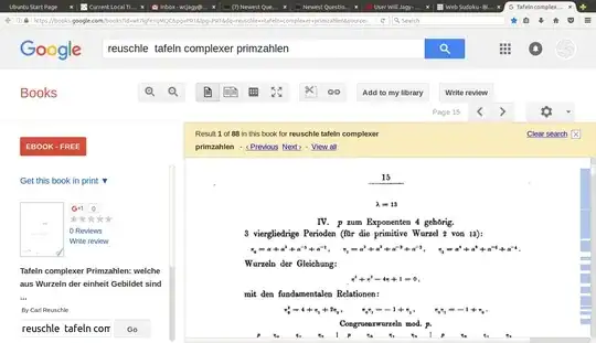

    page 15 in https://books.google.com/books?id=wt7lgfeYqMQC&pg=PR1&lpg=PR1&dq=reuschle++tafeln+complexer+primzahlen&source=bl&ots=VGZFPrfUBn&sig=MlQ667PqXaQ9rAvLWkG3_F1rwsk&hl=en&sa=X&ved=0ahUKEwiIwtSvm9TQAhUJ-2MKHXJIA_kQ6AEIODAE#v=onepage&q=reuschle%20%20tafeln%20complexer%20primzahlen&f=false I bought a cheap paperback reprint print-on-demand better to see how the book is organized He does all the primes up to 97, then various composite numbers. Method was introduced in Gauss Disquitiones – Will Jagy Mar 21 '17 at 17:38

Reuschle uses $x^3 + x^2 - 4 x + 1$ which is what you get by the method of Gauss, see page 15, jpeg below. I recommend Galois Theory by David A. Cox, chapter 9 for a modern exposition. Method introduced by Gauss in Section VII of the Disquisitiones, some 30 years before Galois Theory. Gauss did few examples, it does take some practice.

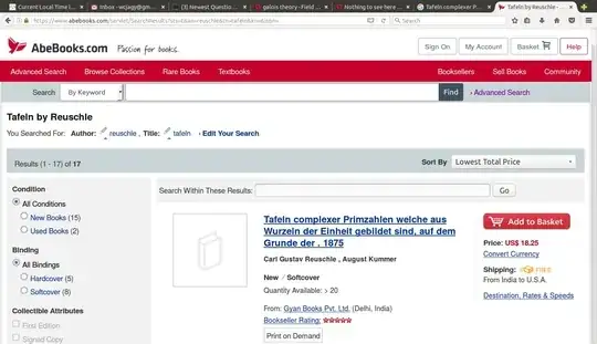

Why not: here is a jpeg from the AbeBooks site, showing how to order Reuschle(1875) as a paperback on-demand reprint. The reprint is from a free online source, they don't have a big library of actual old books there at the printing location. I really prefer having actual books to read rather than just on a computer screen.

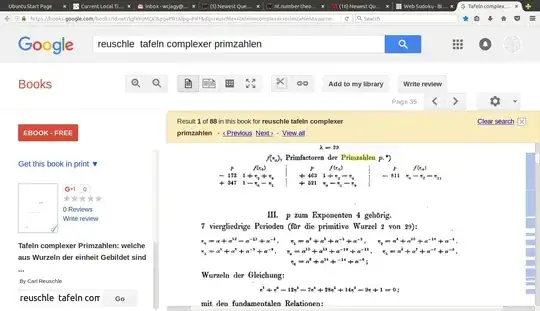

I wrote programs in November and December (2016) to do this. So, here is the whole song and dance for degree 7, prime 29:

  x^7 + x^6 - 12 x^5 - 7 x^4 + 28 x^3 + 14 x^2 - 9 x + 1
 constant 289
   p  29 p.root  2 exps 12^k
 list of the 4 exponents
       1      12      17      28
   $$   x^7 + x^6 - 12 x^5 - 7 x^4 + 28 x^3 + 14 x^2 - 9 x + 1, \; \;  p = 29, \; \;  r = 2, \; \; 12^k  $$

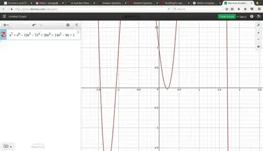

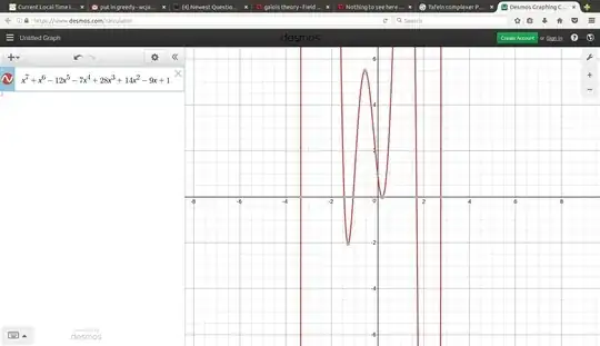

? f = x^7 + x^6 - 12 * x^5 - 7 * x^4 + 28 * x^3 + 14 * x^2 - 9 * x + 1
%1 = x^7 + x^6 - 12*x^5 - 7*x^4 + 28*x^3 + 14*x^2 - 9*x + 1
? polroots(f)
%2 = [
-3.347297326211866604824677822 + 0.E-28*I,
-1.453219237250277575521353021 + 0.E-28*I,
-1.063840303785358166816481464 + 0.E-28*I,
 0.1723984388388905398234384116 + 0.E-28*I,
 0.2395267590849948773703028220 + 0.E-28*I,
 1.700463948582122544295969145 + 0.E-28*I,
 2.751967720741494385672801928 + 0.E-28*I]~
some of these roots are $$ 2 \cos \left( \frac{2 \pi}{29} \right) + 2 \cos \left( \frac{24 \pi}{29} \right) = 2 \cos \left( \frac{2 \pi}{29} \right) - 2 \cos \left( \frac{5 \pi}{29} \right) \approx 0.239526759 $$ $$ 2 \cos \left( \frac{4 \pi}{29} \right) + 2 \cos \left( \frac{48 \pi}{29} \right) = 2 \cos \left( \frac{4 \pi}{29} \right) + 2 \cos \left( \frac{10 \pi}{29} \right) \approx 2.75196772 $$ $$ 2 \cos \left( \frac{8 \pi}{29} \right) + 2 \cos \left( \frac{96 \pi}{29} \right) = 2 \cos \left( \frac{8 \pi}{29} \right) - 2 \cos \left( \frac{9 \pi}{29} \right) \approx 0.1723984 $$ $$ 2 \cos \left( \frac{16 \pi}{29} \right) + 2 \cos \left( \frac{192 \pi}{29} \right) = -2 \cos \left( \frac{13 \pi}{29} \right) - 2 \cos \left( \frac{11 \pi}{29} \right) \approx -1.06384 $$ $$ 2 \cos \left( \frac{32 \pi}{29} \right) + 2 \cos \left( \frac{384 \pi}{29} \right) = -2 \cos \left( \frac{3 \pi}{29} \right) - 2 \cos \left( \frac{7 \pi}{29} \right) \approx -3.347297326 $$ $$ 2 \cos \left( \frac{64 \pi}{29} \right) + 2 \cos \left( \frac{768 \pi}{29} \right) = 2 \cos \left( \frac{6 \pi}{29} \right) + 2 \cos \left( \frac{14 \pi}{29} \right) \approx 1.70046 $$ $$ 2 \cos \left( \frac{128 \pi}{29} \right) + 2 \cos \left( \frac{1536 \pi}{29} \right) = 2 \cos \left( \frac{12 \pi}{29} \right) - 2 \cos \left( \frac{ \pi}{29} \right) \approx -1.4532 $$
