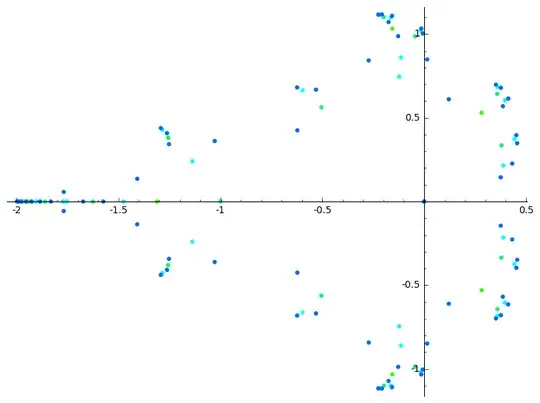

This is for the first 7 polynomials 7 poly

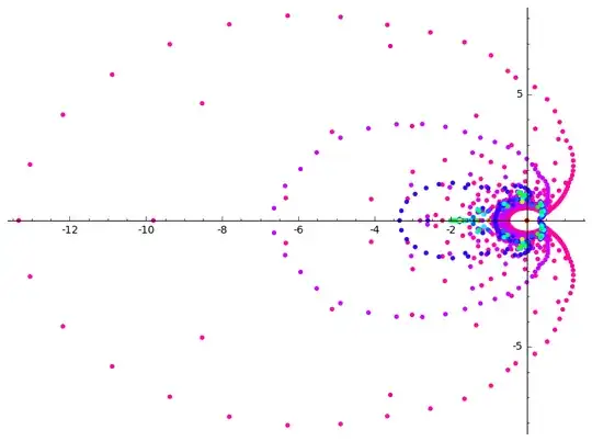

This is all 10 10 poly

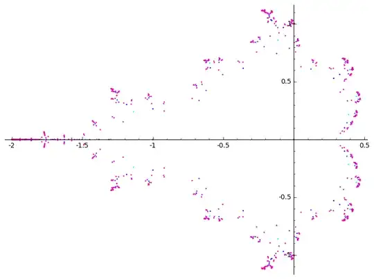

Doing this gives us the great pictures like
Pretty almost Mandelbrot looking like image
And here's a live version with the iteration count reduced by one to get it to run a little faster.
