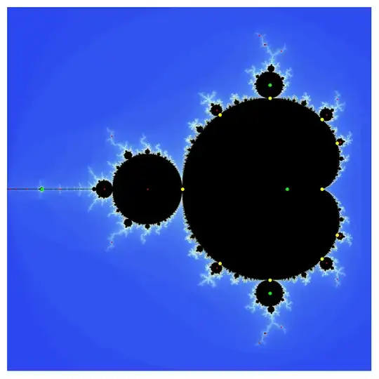

Theorem 2 and its corollary show why we care about whether the critical orbit escapes or not. As an application of the lemma, consider the problem of finding the so-called "hyperbolic components" of the Mandelbrot set. These are just the different, conspicuous pieces of the Mandelbrot set that we see - like the cardioids and circles. They all contain exactly one $c$ value with the property that the corresponding function $f_c$ has a super-attractive fixed point. Thus, we can find these by finding $c$ values where zero maps back to itself under iteration of $f_c$. Put another way, these are the roots of the critical polynomials associated with $f_c$.
This is illustrated in the following figure:
The green and red dots are all roots of some critical polynomial of $f_c$. If you're curious about the yellow dots, check out this answer, which is where the picture comes from.

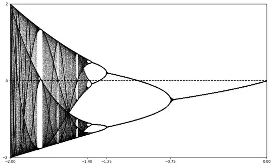

As another illustration, have a look at this image of the bifurcation diagram for the quadratic family, with plots of the critical polynomials super-imposed on top:
Note that the curves mesh quite nicely with the image; the points naturally cluster near those curves. The curves are evident, even when they aren't explicitly drawn. Also, the periodic windows arise at the roots of the critical polynomials because, again, that's where a super-attractive orbit can arise.
