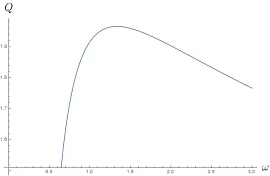

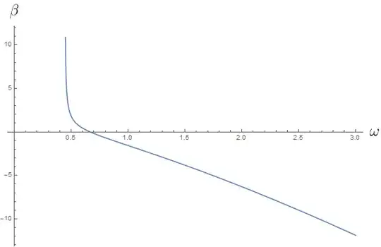

To show why I select $\beta = 0$ as the maximal case. Consider the plot of $Q$ against $\omega$. If we input some reasonable (physically sound) values for $M = 4.5$ and $B = 2$ we have
So we can see that $Q$ has a maximal value. However, plotting $\beta$ against $\omega$ for the same values of $M,B$ shows us that $\beta$ gives a negative value at this maximal value, which is unphsyical. So the maximal $Q$ goes with $\beta = 0$.

  • What I mean to say is we must have that $Q > 0$ which implies that $\omega > B/M$. As $Q$ increases we have $\omega$ increasing. At the extremum $Q_\omega = 0$ we have $\omega = 3B/M$ however this implies $\beta < 0$ which is unphysical (because I need $-1 / \lambda > 0$). So as $\omega$ has increases from $B/M$ to $3B/M$ there exists a value at which $\beta$ becomes negative. So the case $\beta = 0$ gives $\omega = 3B/2M$, which must be the maximal physical $Q$. – mch56 Mar 30 '17 at 08:56
