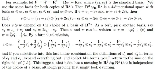

The above definition relies on a choice of basis, which can not be done canonically for a generic vector space. However, any two choices of basis lead to isomorphic tensor product spaces (c.f. the universal property described below). Alternatively, the tensor product may be defined in an expressly basis-independent manner as a quotient space of a free vector space over $V\times W$. This approach is described below.

If we decide on the standard Euclidean orthonormal basis, what is the final expression of the $v\otimes w$ product in the red boxed expression? Do we eventually get rid of the vector expressions with hats (as well as the $\otimes$ symbols) to get a number as per the (approximate) idea of a tensor as a map from $V\times W\rightarrow \mathbb R?$
What if we change the bases from orthonormal to $\large\begin{bmatrix}\tilde x\\\tilde y\\\tilde z\end{bmatrix}=\begin{bmatrix}3&4&-1\\0&3&7\\1&3&0.5\end{bmatrix}\begin{bmatrix}\hat x\\\hat y\\\hat z\end{bmatrix}?$
