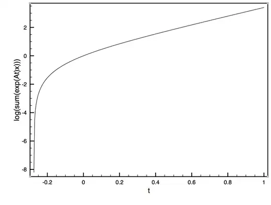

Here is an example of what it tends to look like. For this example, $$ A = \begin{pmatrix}1,1\\4,1\end{pmatrix}, \qquad \mathbf{x} = \begin{pmatrix}1\\0\end{pmatrix}. $$
N. Virgo

  • Not always convex, try $A=[[1,1][4,1]]$ and $x =(1,0)$. – Did Feb 27 '17 at 16:47
  • @Did it looks convex to me. For what range of $t$ values are you seeing a concavity? – N. Virgo Feb 27 '17 at 23:57
  • @Did I added a plot to the question – N. Virgo Feb 28 '17 at 00:05
  • @Nathaniel What you plotted is concave. – Dirk Feb 28 '17 at 00:08
  • My first random $5\times 5$ example had both convex and slightly concave parts. – Dirk Feb 28 '17 at 00:18

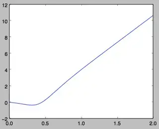

Ok, so I can finally put this question to bed with a numerical example. Here is a plot of $\log Z$ against $t$ for some particular non-negative matrix $A$:
The second derivative clearly changes sign twice, once at around 0.3 and again just after 0.5.
It's probably not worth printing the whole matrix here since it's $100\times 100$ and there must be smaller, more instructive examples, but it was generated with the following rather arbitrary Python code:
n = 100
A = np.random.random((n,n)) # should be a Metzler matrix
A = np.exp(W*2)
A = W - np.eye(n)
A[np.random.random((n,n))>0.02] = 1e-3
(The point was to put the leading eigenvalue close to the cloud of other eigenvalues that random matrices tend to exhibit.)

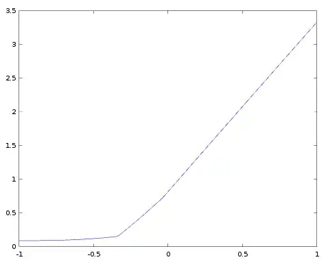

Here is a random counter example:
A =
0.3384042   0.1355143   0.2244029   0.0094600   0.3658720
0.7335746   0.5823969   0.9182229   0.8483730   0.9743839
0.3992142   0.6501968   0.8946143   0.8120155   0.5938882
0.8255626   0.0570781   0.2135843   0.8498636   0.1053567
0.4915833   0.7814256   0.1870035   0.4286809   0.6484581
x =
0.384444
0.441505
0.623156
0.016760
0.791119
This produces this function like this: enter image description here
Looks pretty convex (although I am not sure if you are probably after concavity), but its not. Around zero there is slightly decreasing derivative…
Dirk
  • 12,026
  • It doesn't look remotely like that when I plot it. Are you sure you're calculating it correctly? – N. Virgo Feb 28 '17 at 01:48

    Oh, I just realized that by $|\cdot|$ you meant the sum of the elements (and not the sum of the absolute values) - quite unfortunate notation I think. Since $\exp(At)$ has some negative entries, this makes the difference. – Dirk Feb 28 '17 at 06:55
