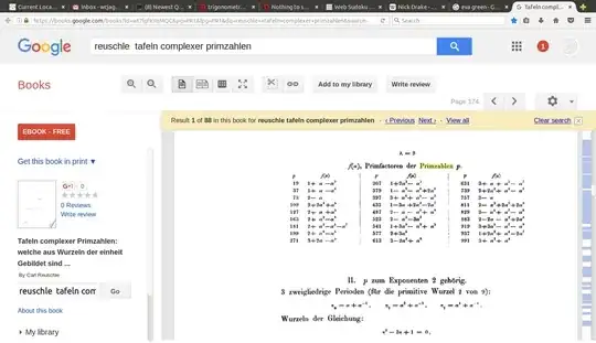

A clean start, not remotely obvious ( but easy enough to prove ), the roots of $$ x^3 - 3 x + 1 $$ are $$ 2 \cos \frac{2 \pi}{9}, \; \; 2 \cos \frac{4 \pi}{9}, \; \; 2 \cos \frac{8 \pi}{9}. $$ From page 174 in Reuschle (1875). The method used is due to Gauss.
I learned today that, in 1933, D. H. Lehmer published a two-page proof that $2 \cos (2k\pi/n)$ is always an algebraic integer. Mentioned in an article in the January (M. A. A.) Monthly by Y. Z. Gurtas.
We immediately get that the roots of $$ 8 x^3 - 6 x + 1, $$ therefore $$ x^3 - \frac{3}{4} x + \frac{1}{8} $$ are $$ \cos \frac{2 \pi}{9}, \; \; \cos \frac{4 \pi}{9}, \; \; \cos \frac{8 \pi}{9}. $$ Compare with the three requested proofs in the answer by Michael R.
