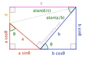

Riffing on @Yves' "little known" solutions ...
The above trigonograph shows a scenario with $a^2 + b^2 = c^2 + d^2$, for $d \geq 0$, and we see that $$\theta = \operatorname{atan}\frac{a}{b} + \operatorname{atan}\frac{d}{c} \tag{1}$$ (If the "$a$" triangle were taller than the "$b$" triangle, the "$+$" would become "$-$". Effectively, we can take $d$ to be negative to get the "other" solution.) Observe that both $c$ and $d$ are expressible in terms of $a$, $b$, $\theta$: $$\begin{align} a \sin\theta + b \cos\theta &= c \\ b \sin\theta - a\cos\theta &= d \quad\text{(could be negative)} \end{align}$$ Solving that system for $\sin\theta$ and $\cos\theta$ gives $$\left.\begin{align} \sin\theta &= \frac{ac+bd}{a^2+b^2} \\[6pt] \cos\theta &= \frac{bc-ad}{a^2+b^2} \end{align}\quad\right\rbrace\quad\to\quad \tan\theta = \frac{ac+bd}{bc-ad} \tag{2}$$ We can arrive at $(2)$ in a slightly-more-geometric manner by noting $$c d = (a\sin\theta + b \cos\theta)d = c( b\sin\theta - a \cos\theta ) \;\to\; ( b c - a d)\sin\theta = \left( a c + b d \right)\cos\theta \;\to\; (2) $$ where each term in the expanded form of the first equation can be viewed as the area of a rectangular region in the trigonograph. (For instance, $b c \sin\theta$ is the area of the entire figure.)
