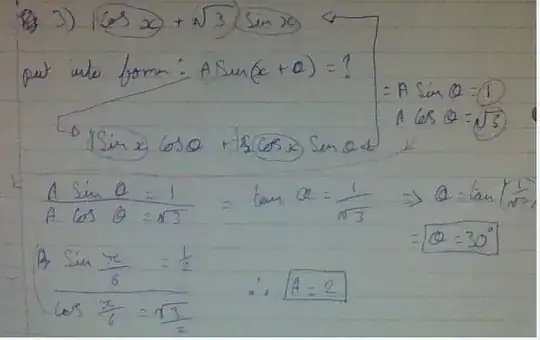

The task is to manipulate $$\cos(x) + \sqrt{3}\sin(x)$$
into the form $$A\sin(x+ \theta)$$
My question is : why is $\pi$ in the numerator and denominator both divided by $6$?
I am familiar with most of the question, however I get stuck in a certain area. The following image shows the question as a whole:- enter image description here
I am unsure why $\pi$ in the numerator and denominator are both divided by $6$?
Please can someone explain how this is so ?
Many thanks.
    I recommend you type your steps out instead of giving us a picture for your future questions. – Arbuja Jan 31 '16 at 02:26
    Because $30^\circ={\pi\over6}$ radian. – Jack's wasted life Jan 31 '16 at 02:26
  • @Jack'swastedlife, that's what I initially thought, however I set my calculator to Rad and inputted π/6 and the result was 0.5235. – Aztec warrior Jan 31 '16 at 02:30
    Your calculator is giving you numerical value of ${\pi\over 6}$, it's not doing unit conversion. – Jack's wasted life Jan 31 '16 at 02:31

First expand $\sin(x+\theta)$:
$$\sin(x+\theta)=\cos(\theta)\sin(x)+\sin(\theta)\cos(x)$$
Since You want to find $A$ such that
$$A\sin(x+\theta)=\cos(x)+\sqrt{3}\sin(x)$$
You obtain the following conditions for $\theta$:
$$ \begin{cases} \sin(\theta)=1/A\\ \cos(\theta)=\sqrt{3}/A \end{cases} $$
Now using the Pythagoras theorem one gets $1=\sin^2(\theta)+\cos^2(\theta)=4/A^2$ from where $A=2$. Finally from
$$ \begin{cases} \sin(\theta)=1/2\\ \cos(\theta)=\sqrt{3}/2 \end{cases} $$
we get $\theta=\pi/6$.
  • Thankyou for your response, I can say I follow most of the process. Please may you explain in a little more detail where you have got $$4/A^2$$ , and how does A = 2 ? Sorry for the inconvenience. – Aztec warrior Jan 31 '16 at 02:58
  • $1=\sin^2(\theta)+\cos^2(\theta)=(1/A)^2+(\sqrt{3}/A)^2=4/A^2$. Now multiply by $A^2$, and take the square root. – Marcin Malogrosz Jan 31 '16 at 03:44
