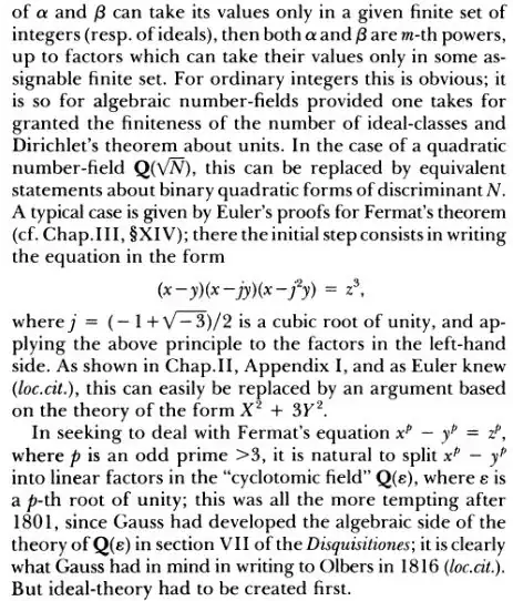

There are many examples from number theory. One of the simplest is the parametrization of primitive Pythagorean triples. When viewed in the Gaussian integers $\,\Bbb Z[i] = \{ a + b\,i\,: a,b\in\Bbb Z\}$ the parametrizaton arises immediately from the fact that coprime factors of a square must themselves be squares (up to unit multiples), which is true for the Gaussian integers because they too, like natural integers, enjoy unique prime factorization.
Indeed if $\ z^2 = x^2 + y^2 = (x-y\,i) (x+ y\,i) $ and $\,x,y\,$ are coprime then one easily checks that $\,x-y\,i,\,x+y\,i\,$ are coprime, so being coprime factors of the square $\,z^2$ they must themselves be squares (up to a unit factor). Thus e.g. $\ x + y\ i\, =\, (m + n\ i)^2 =\ m^2 - n^2 + 2mn\, i,\,$ hence $\,x = m^2-n^2,\ y = 2mn\,$ (using the unit factor $1$; using the other unit factors $\, -1,\pm i\,$ merely changes signs or swaps $\,x,y\,$ values). Notice how very simple the solution is from this perspective.
Similarly one can solve low degree cases of Fermat's Last Theorem by employing analogous factorizations over certain rings of algebraic integers. For example, Gauss showed there are no solutions for exponent $3$ by working in the ring of integers of $\rm\ \mathbb Q(\sqrt{-3})\:,\: $ and Dirichlet did similarly for exponent $5$ using $\rm\ \mathbb Q(\sqrt{5})\:.$ Later Kummer generalized these techniques to handle all regular prime exponents by working over rings of cyclotomic integers. For a nice exposition see Ribenboim: 13 lectures on Fermat's last theorem. Weil nicely summarizes the essence of these techniques in his Number Theory, Ch.IV,S.VI,p.335:
alt text alt text

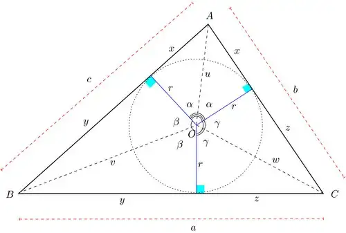

A friend of mine came up with a proof of Heron's formula for the area of a triangle which uses complex numbers. I can't find the original publication, but the proof appears on pages 2-4 in Six mathematical gems from the history of Distance Geometry by Leo Liberti and Carlile Lavor. For completeness, I'll reproduce it here.
Heron's Formula: The area of a triangle with sidelengths $a$, $b$, and $c$ is given by $K = \sqrt{s(s-a)(s-b)(s-c)}$, where $s = \tfrac{1}{2}(a+b+c)$ is the semi-perimeter.
Proof: Let's start by drawing a triangle $\Delta ABC$ with sidelengths $BC = a$, $CA = b$, and $AB = c$, along with the inscribed circle centered at $O$ with radius $r$. Let the external tangents to the circle from $A$, $B$, and $C$ have lengths $x$, $y$, and $z$ respectively. Also, let $u = OA$, $v = OB$, $w = OC$, and let $\alpha$, $\beta$, and $\gamma$ be the angles centered at $O$ as shown in the diagram below.
The area of $\Delta ABC$ is the sum of the areas of $\Delta OBC$, $\Delta OCA$, and $\Delta OAB$ which is $K = \dfrac{1}{2}ra + \dfrac{1}{2}rb + \dfrac{1}{2}rc = rs$, so we simply need to find an expression for $r$ in terms of $a,b,c$. This is where complex numbers becomes useful.
Since $r = u\cos\alpha$ and $x = u\sin\alpha$, we can write $r+ix = ue^{i\alpha}$. Similarly, $r+iy = ve^{i\beta}$ and $r+iz = we^{i\gamma}$. Then, since $2\alpha+2\beta+2\gamma = 2\pi$, we have $\alpha+\beta+\gamma = \pi$. Therefore, \begin{align} (r+ix)(r+iy)(r+iz) &= (ue^{i\alpha})(ve^{i\beta})(we^{i\gamma}) \\ r^3+ir^2(x+y+z)+i^2r(xy+yz+zx)+i^3xyz &= uvwe^{i(\alpha+\beta+\gamma)} \\ r^3+ir^2(x+y+z)-r(xy+yz+zx)-ixyz &= uvwe^{i\pi} \\ \underbrace{[r^3-r(xy+yz+zx)]}_{\text{real}}+\underbrace{i[r^2(x+y+z)-xyz]}_{\text{imaginary}} &= \underbrace{-uvw}_{\text{real}}. \end{align}
By equating imaginary parts, we get that $r^2(x+y+z)-xyz = 0$, i.e. $r = \sqrt{\dfrac{xyz}{x+y+z}}$.
Then, since $a = y+z$, $b = z+x$, and $c = x+y$, we have $2s = a+b+c = 2x+2y+2z$. Hence, $s = x+y+z$, and so, $x = s-a$, $y = s-b$, and $z = s-c$.
Therefore, $r = \sqrt{\dfrac{(s-a)(s-b)(s-c)}{s}}$, and thus, $K = rs = \sqrt{s(s-a)(s-b)(s-c)}$.
