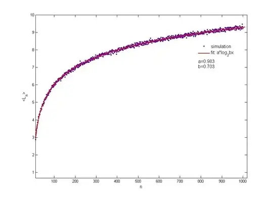

You may want to look at the following plot I got a while back. For $1\le n\le 1000$ $\langle L_n\rangle$ is calculated using $1000$ trails of $n$ unbiased coin tosses:

  • Nice graphic. It actually helped me realize that as you flip a coin more and more, the max number of head coin flips in a row you witness will increase gradually over time. It's also interesting to see that it will also start to flat out as the amount of flips increases. I'm assuming the plot will eventually start to look like a flat horizontal line with very little movement after a while. I'm guessing we could probably also calculate how many times on avg. you would have to flip a coin to get a certain number of heads in a row. mind blown – Juan Velez Aug 25 '15 at 20:02
    "I'm assuming the plot will eventually start to look like a flat horizontal line with very little movement after a while" - well, it grows logarithmically, so clearly the length of the longest sequence tends to infinity (although slower than you might have expected). As to your last comment, suppose you managed to calculate the probability $p_k$ of having a largest sequence of size $k$ (in $n$ tosses), then the number of $n$ tosses trials you need in order to witness a $k$ longest sequence is geometrically distributed and it's expectation is $\frac{1}{p_k}$. – Ariel Aug 25 '15 at 20:24
  • @Ariel: yes, and yet in another sense it does tend to a flat line because the slope approaches zero! Such is the way of limits. – wchargin Aug 26 '15 at 01:12

Note, that the value $9.29853$ at $n=1000$ nicely matches with the $graph$ presented in the answer from @Ariel and the first order approximation $\lg(n)$ is the one provided in the answer by @leonbloy.
