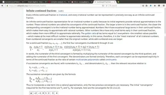

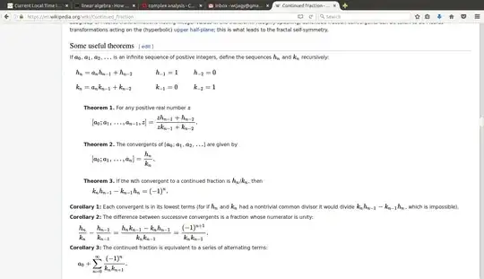

Here are the basic rules from wikipedia. They use $h_n/k_n$ rather than $p_n/ q_n,$ but they keep the $a_n.$
