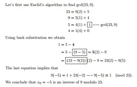

In order to find an inverse of a congruence, do we have to go through Euclid’s algorithm and do back substitution?
Here is an example to find an inverse of 9 modulo 23. enter image description here

  • You have the extended Euclidean algorithm which gives directly the gcd and the Bézout's coefficients, hence the modular inverse. Please see my answer to this question for an example with the standard layout, and my answer to this other question for a sketch of the justification. – Bernard Nov 24 '16 at 00:07
  • You can avoid the tedious error-prone back-substitution in the extended Euclidean algorithm by instead using this more convenient version of the algorithm. – Bill Dubuque Nov 24 '16 at 00:19
  • I dunno. Common sense says 23 = 3x9 -4. so $1/9 = 3/27 = 3/4. 23 =64 -1$. So $3/4 = 18/24 = 18$. Its basically euclids algorithm but without needing to keep a tally. Harder example 1/27 mod 103. 1/27=4/108 = 4/5 = 84/105= 84/2=42. Check... $2742 = 1134=1133 + 1 = 103x11 + 1$. Yep. Seems to work. – fleablood Nov 24 '16 at 00:29
  • @fleablood Does your final answer is 18? If so, then there maybe some mistakes in your method. The inverse should be 8. – yashirq Nov 24 '16 at 00:50
  • Why do you think it should be 8? All the answers so far universally (!including the one in the text!) say it is -5 = 18. 9x-5 = -45 = 1 mod 23 and 9x18 = 162 = 723 + 1 = 1 mod 23. But 87 = 72 = 3 mod 23. I think I'm right. – fleablood Nov 24 '16 at 01:07
  • Oh no, my mind is still in another question $8400^{-1}(mod 11}$. My bad. But the inverse is already given in the example, which is -5. Isn't it the unique one? – yashirq Nov 24 '16 at 01:10
  • -5 and 18 are both the same thing mod 23. $-5 \equiv 18 \mod 23$. Likewise any $23k -5 \equiv -5 \equiv 18 \mod 23$ would be acceptable. [-5] and [18] are considered to be the same thing. By convention one usually wouldn't choose to say "the answer is 4342" although it is true that 1/9 = 4342 = -5 mod 23. For sake of clarity one puts the answer in smallest terms. Sometimes it's convenient to do the smallest positive value, 18, as I did. Or sometimes the smallest absolute value, -5, as everyone else did. But -5 and 18 are considered the same as 23 -5 = 18. So, yes, that is a unique answer. – fleablood Nov 24 '16 at 18:16

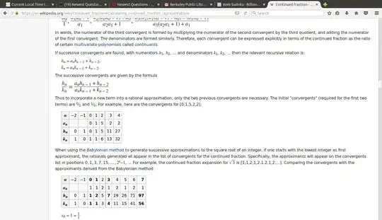

I'm going to type in the example in https://en.wikipedia.org/wiki/Continued_fraction#Calculating_continued_fraction_representations
$$ 3.245, \; 4.081632653, \; 12.25000001, \; 3.999999840 $$ where we believe the 3.999999840 is really 4, integral digits $$ 3, 4, 12, 4. $$
$$ \begin{array}{cccccccccccccccccccccccccccccc} & & & 3 & & 4 & & 12 & & 4 & \\ \frac{0}{1} & & \frac{1}{0} & & \frac{3}{1} & & \frac{13}{4} & & \frac{159}{49} & & \frac{649}{200} & \end{array} $$
One thing this shows is that $3.245 = 649/200.$ Also, $159 \cdot 200 - 649 \cot 49 = -1.$ That is, if you began looking for an inverse of $1000 \pmod {3245},$ this is what you would get, since there is a common factor 5.
Found a place where the wikipedia article shows convergents the way I like to write them:
