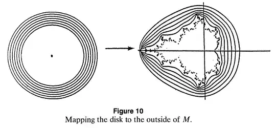

  • Despite expanding finite iterations, there's a series maps the exterior of a unit disk to the exterior of the $M$ set.
    \begin{align*} \psi(z) &= z+\sum_{m=0}^{\infty} \frac{\beta_{0,m+1}}{z^m} \\ z_{n} &= \sum_{m=0}^{\infty} \beta_{n,m} z^{2^n-m} \\ &= z^{2^{n}}+o(1) \end{align*}
    See John H. Ewing, Glenn Schober, The area of the Mandelbrot Set

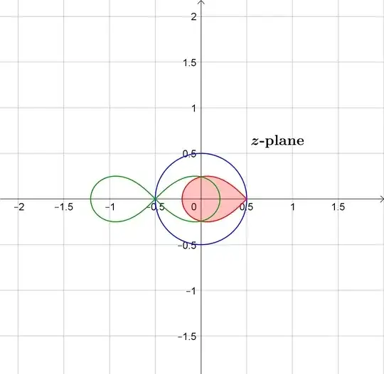

    The boundary of the mapping:
    $$c=\frac{e^{i\theta}}{4} \mapsto z=\frac{1-\sqrt{|\sin \frac{\theta}{2}|+|\sin \frac{\theta}{2}|^2}}{2}- \frac{i\operatorname{sgn} (\sin \theta) \sqrt{|\sin \frac{\theta}{2}|-|\sin \frac{\theta}{2}|^2}}{2}$$

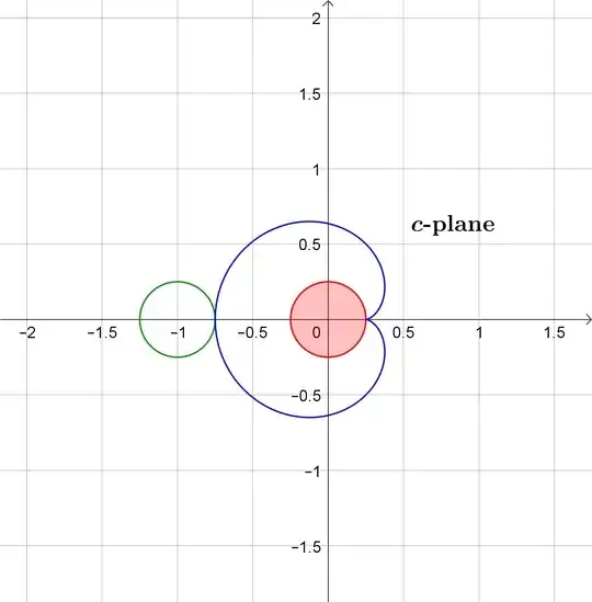

  • The iteration and series agree only when $|c| \le \dfrac{1}{4}$.
    Below is the comparison between the exact iterations (blue) and the series summation (red):
    The green boundaries refer pre-image and image enclosed for period two cycle.
