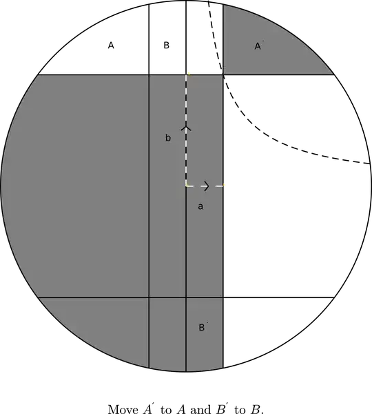

Here is a simple problem which I would occasionally assign to my precalculus students and to my calculus students. The precalculus students always found a simpler answer. Sometimes it is possible to know too much. :)

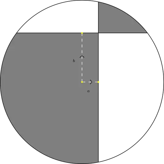

Construct a simple proof that the area of the shaded region of the circle is $$ \frac{1}{2}\pi r^2+2ab $$
Rectangled circle
Caution! Mousing over the yellow region will reveal the answer.
Rectangled Circle "Proof"
Bonus: For those who got the answer or who revealed the answer, what does the dashed line represent? What is its equation?
    That's a neat way to showcase the symmetry. As for the dashed line, my guess would be $,a,b=const,$ i.e. the locus of points which give the same shaded area. – dxiv Dec 16 '16 at 19:14
    @dxiv That's correct. – John Wayland Bales Dec 16 '16 at 19:17

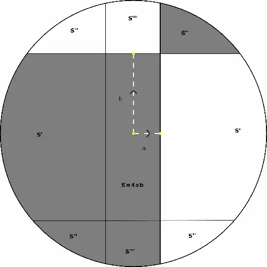

As a variation on the same symmetry clues used in the posted spoiler, the areas of the white and shaded parts are, respectively:
$$ \begin{cases} \begin{align} S_W &= S' + 2 S'' + S''' \\ S_B &= S'+2 S''+S''' + S \end{align} \end{cases} $$
Therefore $S_B-S_W=S=4ab$ and since $S_B+S_W=\pi r^2$ the result immediately follows.
