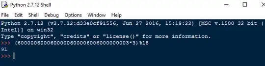

You imply calculators would be an acceptable means, were it not for the limit on number of digits. How about:enter image description here
